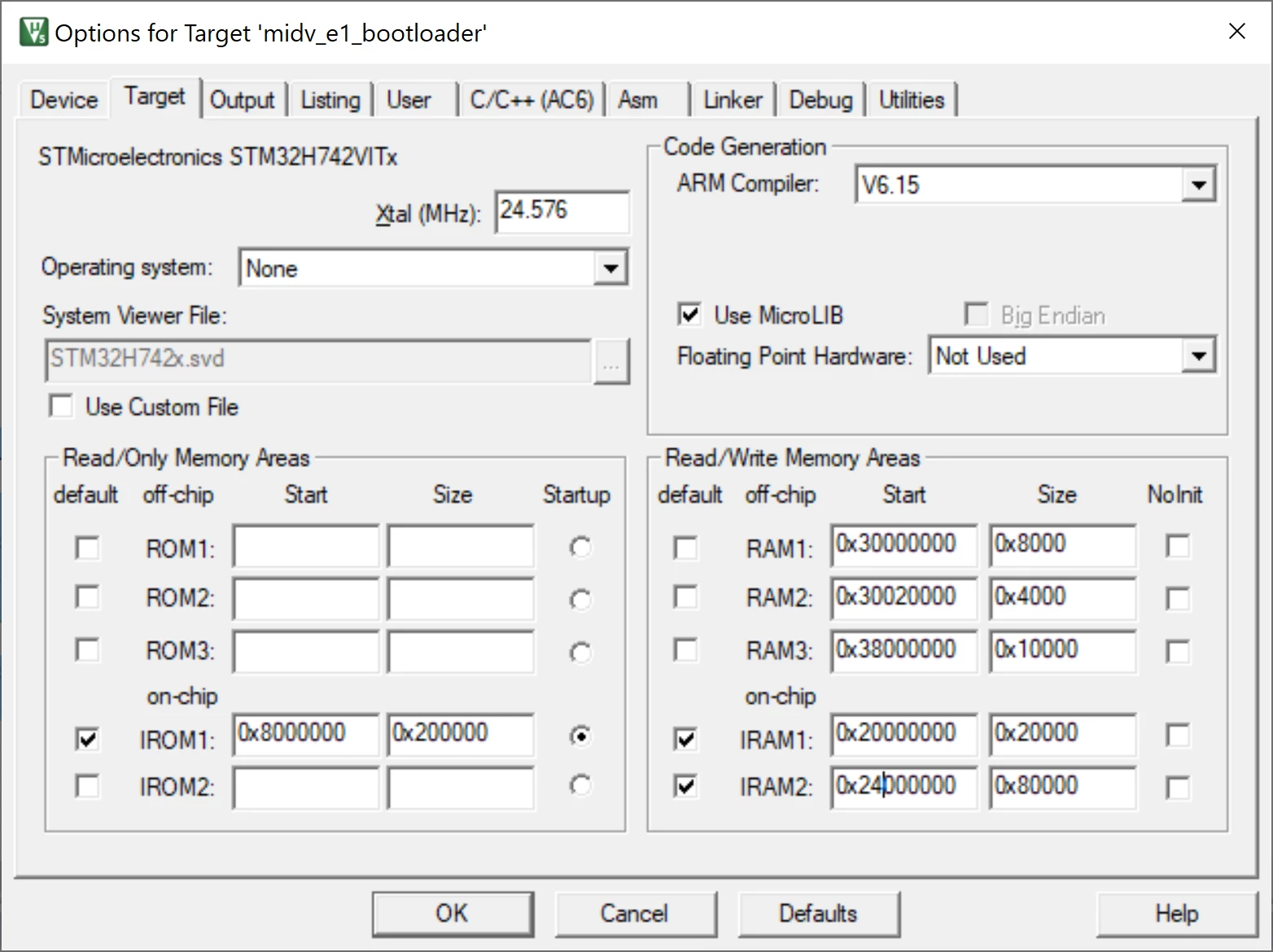

I'm having weird problems with code crashing, perhaps related to how I have IRAM1/IRAM2 set up in my project:

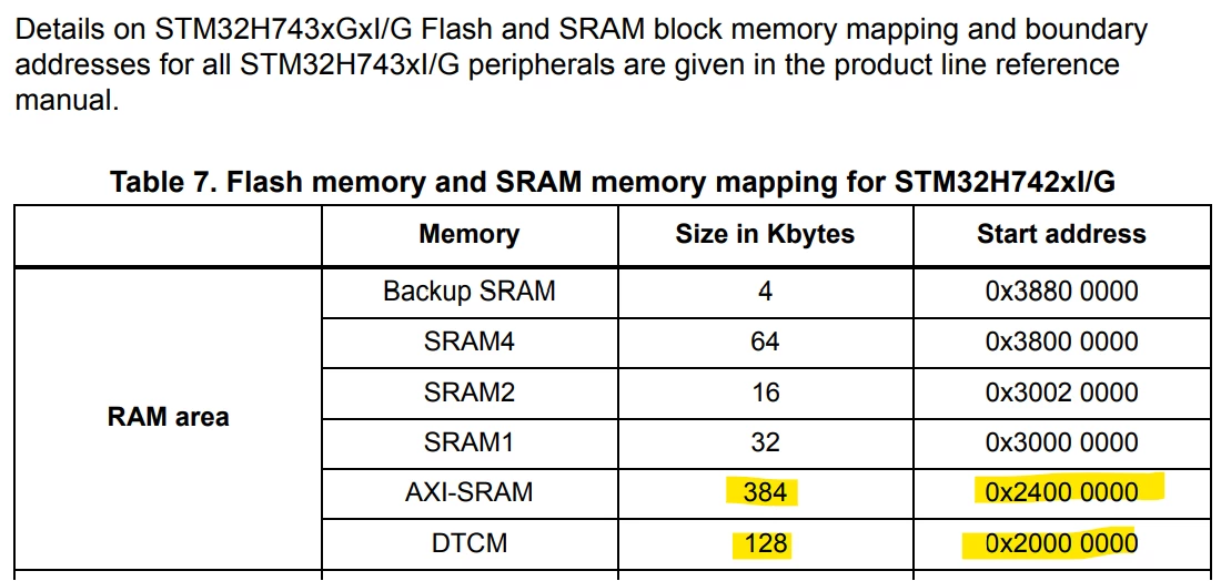

Looking in the reference manual, I see that the SRAM starting at 0x2000_0000 is the DTCM_RAM on TCM interface (data RAM?), the SRAM starting at 0x2400_0000 is the D1 domain, AXI SRAM but I don't see any documentation for how big either of these are.  I also can't figure out what is meant in Keil by IRAM1 vs. IRAM2 (Google is not very helpful), although I suspect that question might not be within the scope of the STM forums...

Memory sizes are in the datasheet and reference manual.
You have AXI SRAM set to 0x80000 but its size is only 0x60000. Could be the issue, could be issues with the code itself.
IRAM = internal RAM. This is Keil terminology.

Ok wait a minute — isn’t 384kB actually 0x6000 and not 0x60000?
EDIT:  Sorry, I was getting 0000 confused with 000!
Tesla DeLorean
Guru
December 21, 2023
No, that's 24KB
0x20000 is 128KB
0x40000 is 256KB
0x80000 is 512KB

December 28, 2023
OK I think I'm getting somewhere now.
I’ve reverted the code to the original static declarations and removed the malloc()/free() calls.
The IRAM1/IRAM2 settings are as in the screenshot at the top except that I've changed the IRAM2 size to 0x60000.
In debug mode, I noticed that the static structures are being placed in memory around 0x24000230-0x24000400.  Also, the stack pointer is jumping around close to these addresses.  So it seems like the stack memory is overlapping with the memory that should have been reserved for zero-initialized data (static structures).  How does the compiler even allow something like this to happen?  I can't find any settings in Keil controlling where the stack memory should be.
I would have thought the zero-initialized data would be placed at the lower available IRAM address (0x20000000) but that is not what the compiler did...
