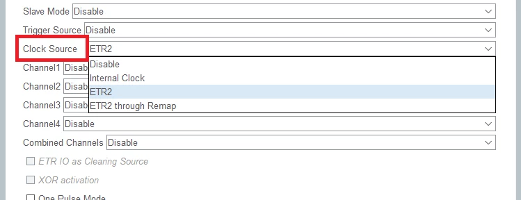

We are trying to use TIM3. We also want to use an external CLK as the clock source for TIM3, but we don't know how to set it.
.ioc file - Where should I change the TIM3 clock source settings?

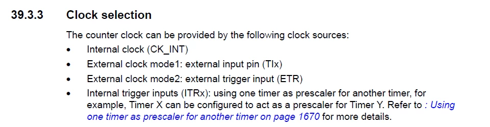

From the reference manual RM0433: / section 39.3.3 Clock selection:
You can select an external clock source for TIM3:
In CubeMx:
In CubeMx:

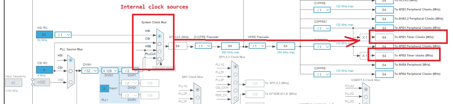

If I select Internal Clock, what will be the accuracy and error of CLK?
It will be the accuracy of the system clock source: HSE/HSI etc ..
HSI, CSI accuracies are provided in the datasheet. HSE depends on the clock source you put as input.
