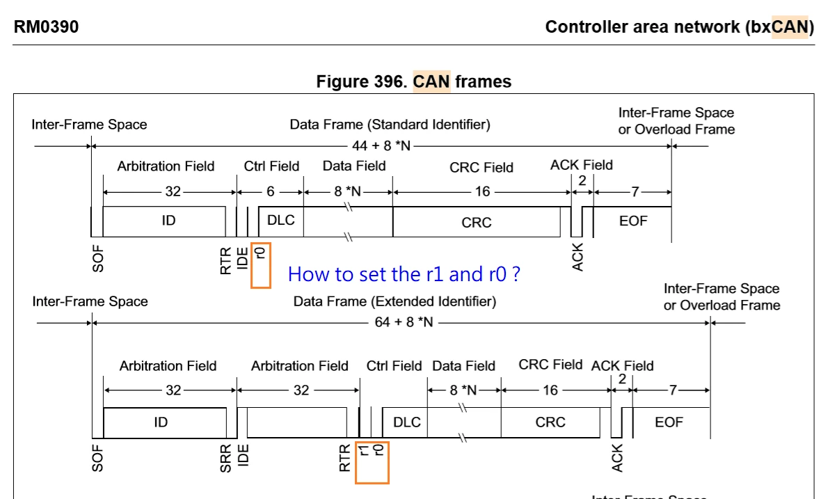

I run the CAN loopback example project by NUCLEO-F446ZE. And find a problem, may I to set the r1 and r0 ? I read the RM0390, no message about it. Could you please let me know How to set the r1 & r0 bits?

    I don't think you can set those bits, it looks like they are reserved by the hardware here.
    Why do you need to set those ?

    When I run the Extented Remote Frame and DLC is 0, I hope to set r1 & r0  to needn't  [1] bit stuff.  If I set r0 'recessive' , and DLC is 0 , there isn't
    [1] bit stuff.

    Why do you want to play there ?,
    R0,R1, are 'Firmware bits that are used to drive the canbus.
