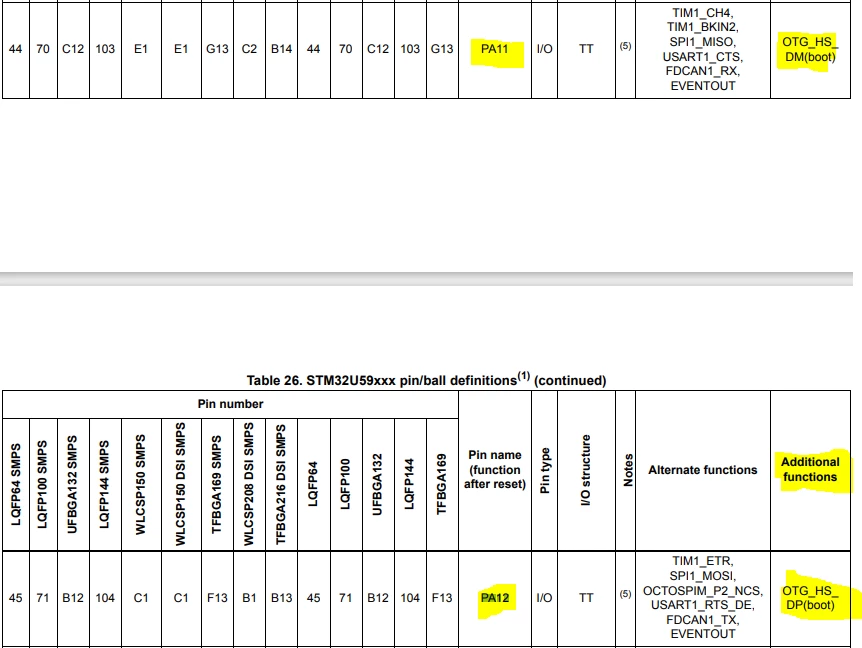

how to set PA11&PA12 to USB_OTG_HS pin after it is set to GPIO
Hello, ST experts
For some reason, PA12 of STM32U595VGT6 is set to GPIO at start up. But I can not find how to set PA12 to USB_DP again in any alternate function of AF1 to AF15.

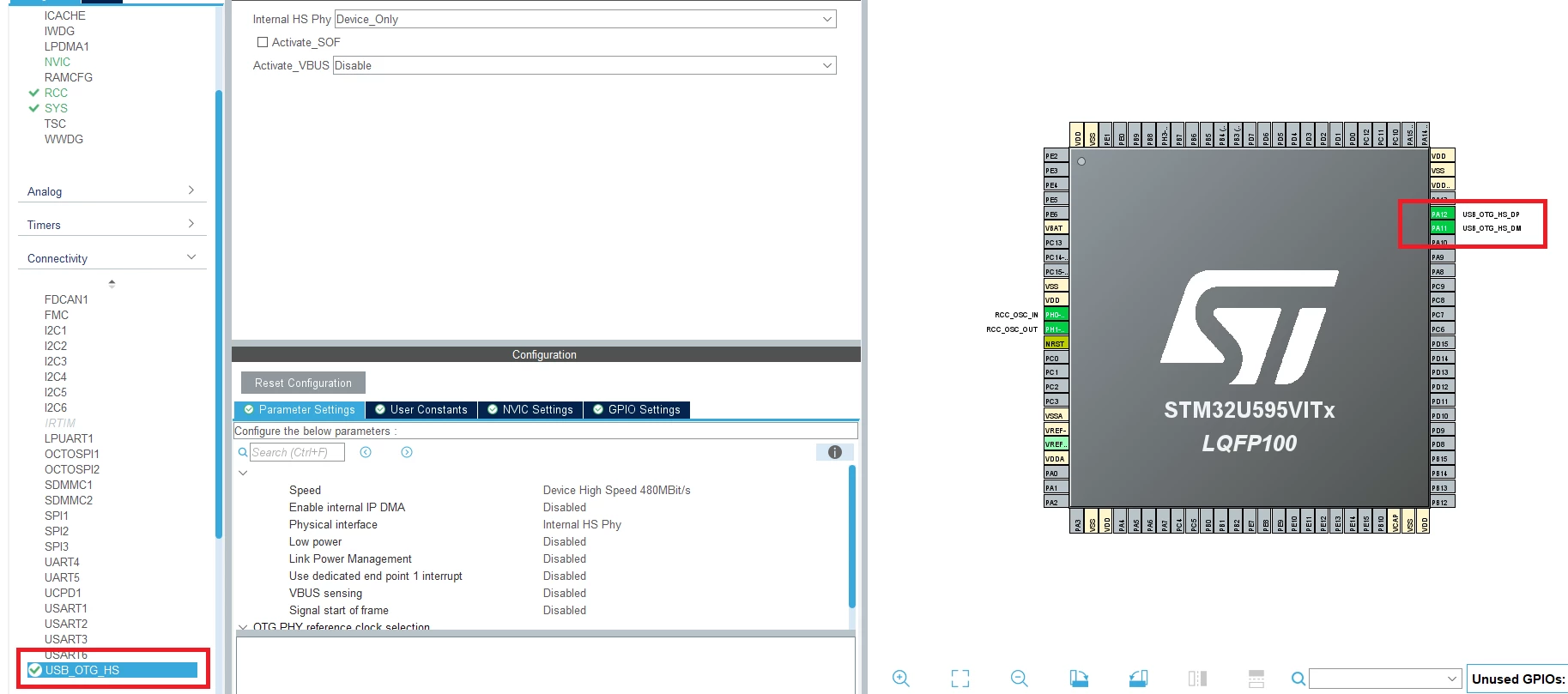

mƎALLEm
Dec 23, 2024 11:26 AM UTC
The issue is not clear.
I can set PA11 and PA12 for USB in CubeMx for STM32U595.

HELLO @Yang Yang
Infact, PA11 and PA12 provide OTG_HS additional functions, and they are not alternate functions:
When you enable the USB_OTG_HS (as done by my college @mƎALLEm ) those Pins are automatically set to OTG_HS additional functions.
Best Regards.

Yang Yang
Yang YangAuthor
Dec 23, 2024 1:27 PM UTC
Hello, ST experts
Yes, actually I found that OTG_HS_DP is additional function. But I don't know how to configure it. In cubemx generated framework is that done by MX_USB_OTG_HS_PCD_Init()?

mƎALLEm
Dec 23, 2024 1:38 PM UTC
You can use CubeMx and configure USB pins as I showed above.
