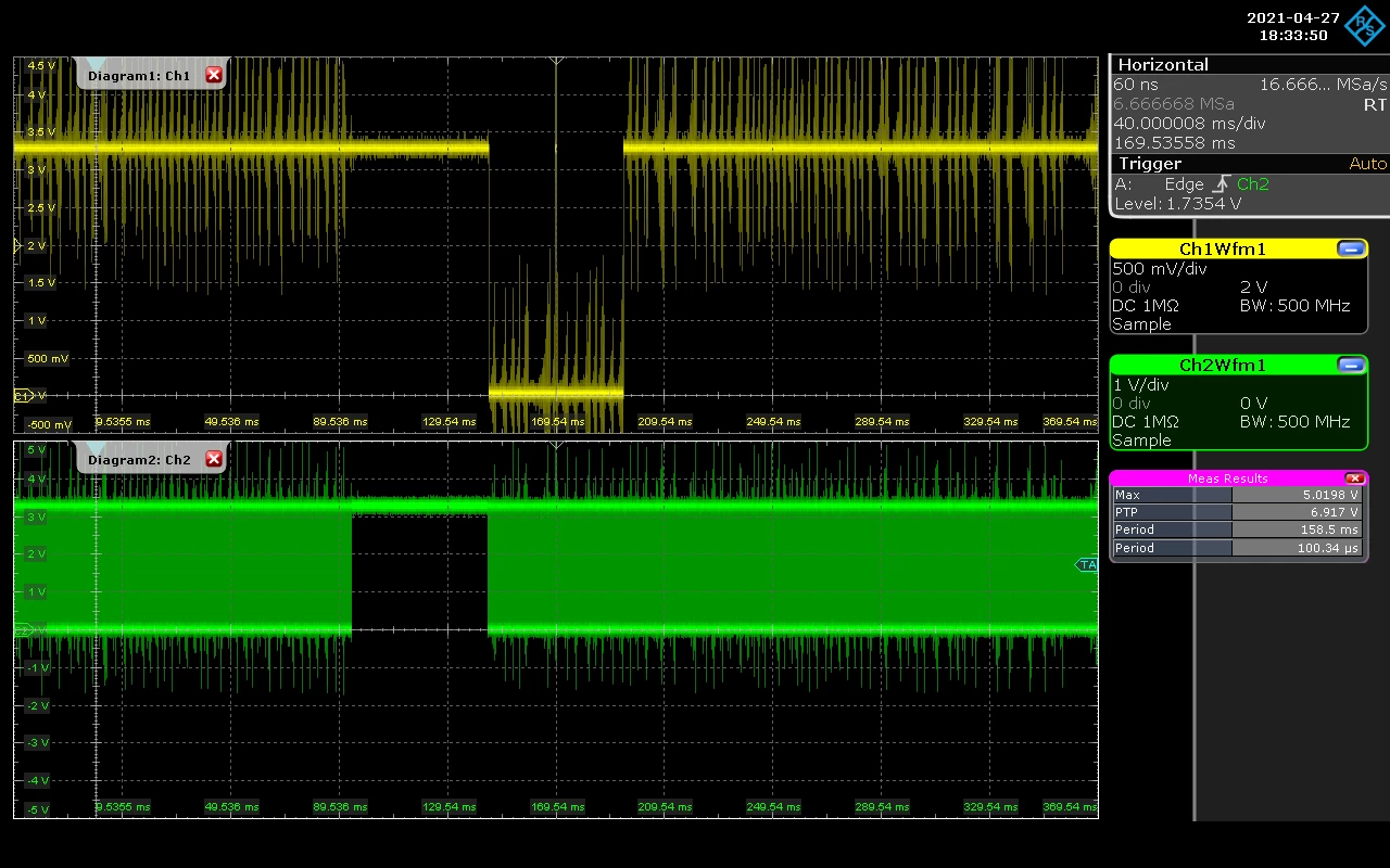

I am having this problem with a variety of signals but let's take for example a 10 kHz signal. I am using the repetition counter to count 9500 times (950 ms) and then be off for 50 ms before turning back on. During the repetition counter part my signal works great but then my signal goes to 3.3V for the 50 ms I want it to be off. Is there a setting somewhere to ensure my signal is at 0 during this off time? For timing reasons, I do not want to stop and start my signal.
