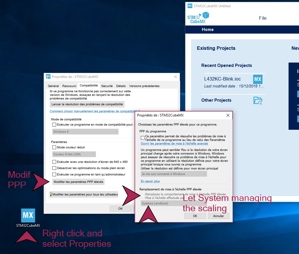

    I have finally found a solution under Windows 10: let the system to manage the scaling of the application STM32CubeMX cf. screenshot below.
