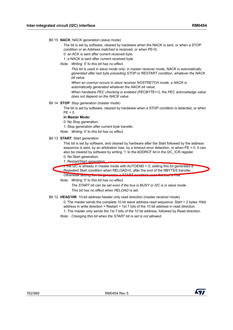

I am trying to set the FRAM memory mb85rc64ta in sleep mode (Datasheet: I cannot copy and paste a link, but it is from Fujitsu and the pdf file is called MB85RC64TA-DS501-00044-4v1-E page 11)
It requires 2 START condition but no STOP condition before the second one. I have tried modifying a HAL function to do this but always I get the second START bit condition, I get a STOP one right before.
How should I do this?

The described condition is called Repeated Start, and generally you achieve it by setting the START bit during the acknowledge phase. Details may depend on the particular I2C module (there are two distinct I2C implementations across STM32 families), e.g.:

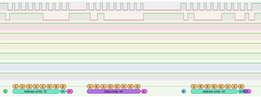

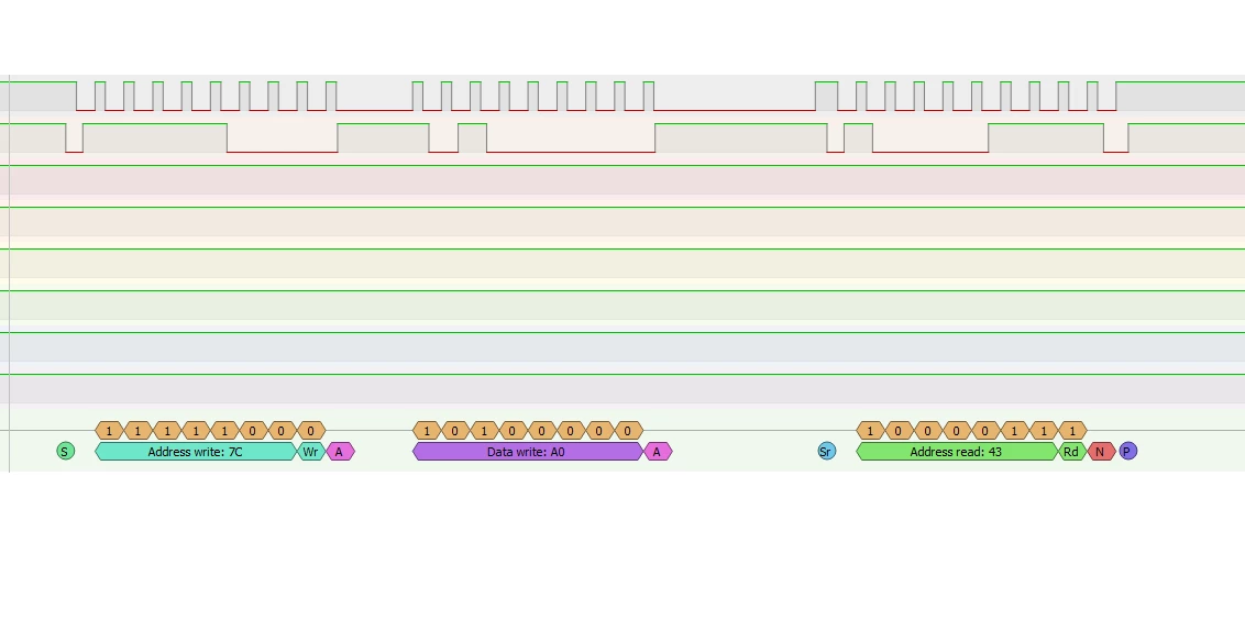

P M
P MAuthor
June 20, 2022
Thank you,
I think I am almost there but there is something I cannot get right.
In case I use a READ operation, I see the sequence fine but I receive a NACK at the end because of the bit flag changeg for the last byte:
0693W00000NsIy4QAF.pngAfter changing the READ operation by a WRITE operation:
The device sends the STOP bit before receiving the ACK from the slave. I cannot understand why this happens. Any idea? I am pretty sure it has to be a very silly issue.
Ok sequence for READ:
MODIFY_REG(hi2c->Instance->CR2, ((I2C_CR2_SADD | I2C_CR2_NBYTES | I2C_CR2_RELOAD | I2C_CR2_AUTOEND | (I2C_CR2_RD_WRN & (uint32_t)(I2C_GENERATE_START_READ >> (31U - I2C_CR2_RD_WRN_Pos))) | I2C_CR2_START | I2C_CR2_STOP)), \
					(uint32_t)(((uint32_t)sleep_command_2) | (((uint32_t)hi2c->XferSize << I2C_CR2_NBYTES_Pos) & I2C_CR2_NBYTES) | (uint32_t)I2C_AUTOEND_MODE | (uint32_t)I2C_GENERATE_START_READ));
Wrong sequence for WRITE:
					(uint32_t)(((uint32_t)sleep_command_2) | (((uint32_t)hi2c->XferSize << I2C_CR2_NBYTES_Pos) & I2C_CR2_NBYTES) | (uint32_t)I2C_AUTOEND_MODE | (uint32_t)I2C_GENERATE_START_WRITE));
