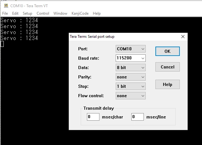

RomainR.Best answer
Oct 28, 2020 2:21 PM UTC
here my test, it works on my side with trace using TeraTerm.
main.c
#include <stdio.h>
/* USER CODE END Includes */
/* USER CODE BEGIN PV */
char str[16] = {0};
uint32_t servopot = 1234;
/* USER CODE END PV */
int main(void)
 /* USER CODE BEGIN 1 */
 /* USER CODE END 1 */
 HAL_Init();
 /* USER CODE BEGIN Init */
 /* USER CODE END Init */
 SystemClock_Config();
 /* USER CODE BEGIN SysInit */
 /* USER CODE END SysInit */
 MX_GPIO_Init();
 MX_USART2_UART_Init();
 /* USER CODE BEGIN 2 */
 int size_len = sprintf (str, "Servo : %lu\n", servopot);
 /* USER CODE END 2 */
 /* Infinite loop */
 /* USER CODE BEGIN WHILE */
 while (1)
 	HAL_UART_Transmit (&huart2, (uint8_t *)str, size_len, HAL_MAX_DELAY);
 	HAL_Delay(1000);
 /* USER CODE END WHILE */
 /* USER CODE BEGIN 3 */
 /* USER CODE END 3 */

Oct 28, 2020 11:48 AM UTC
Hi sangarius,
Set str before calling HAL_UART_Transmit(), and I think sprintf cannot use %d with unsigned long integer.
HAL_UART_Transmit(&huart2, (uint32_t)*str, sprintf(str, "Servo : %d\n", servopot), 0xFFFF);
Try:
uint8_t srt[16] = {0};
int size_len = sprintf (str, "Servo : %ld\n", servopot);
HAL_UART_Transmit (&huart2, (uint8_t)*str, size_len, HAL_MAX_DELAY);

RomainR.
Oct 28, 2020 12:33 PM UTC
oups, sorry.
Not %ld but %lu is the correct format.
If still not work, check baudrate, data bit lenght and uart parity settings.

I'm controlling the servo with potentiometer. "potadc" means the value came from ADC of the potentiometer. "servopot" means potadc/6, the rating of the servo 0-170. I want to see the value of the servopot live when i change the potentiometer.

I write this code inside the loop. It worked. Thanks.
