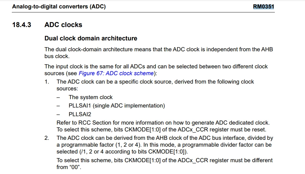

The reference manual says that I could choose the system clock, PLLSAI1, or the PPLSAI2

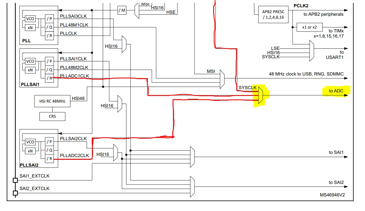

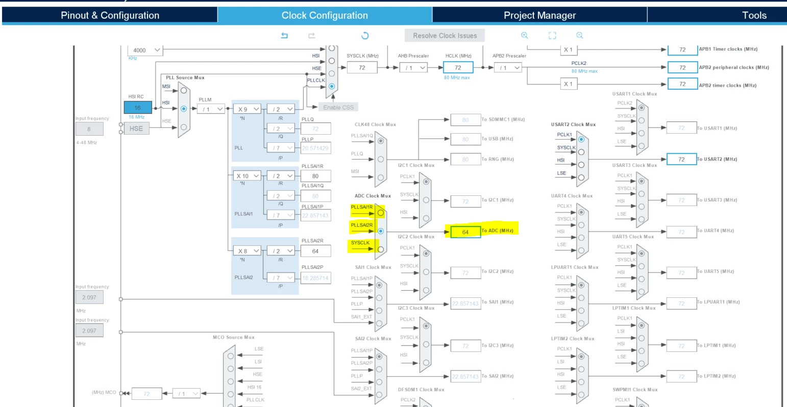

as the asynchronous clock source for the ADC (see figure 1). It also shows that there is a mux that I presume allows the programmer to select between the three clocks. I am trying to configure the ADC at the register level (just for fun) but my problem is that I can't seem to find any information on the registers that controls the MUX to select between the 3 clocks mentioned above. I thought for sure the MUX must exist because the STM32CubeIDE even shows it in the ".ioc" GUI under clock configuration (see figure 3).

Figure 1: Reference manual stating users can choose between  system clock, PLLSAI1, or the PPLSAI2
Figure 2 Refence manual showing a MUX to choose ADC clock source.
Figure 3: STM32CudeIDE showing the MUX to select ADC clock source.

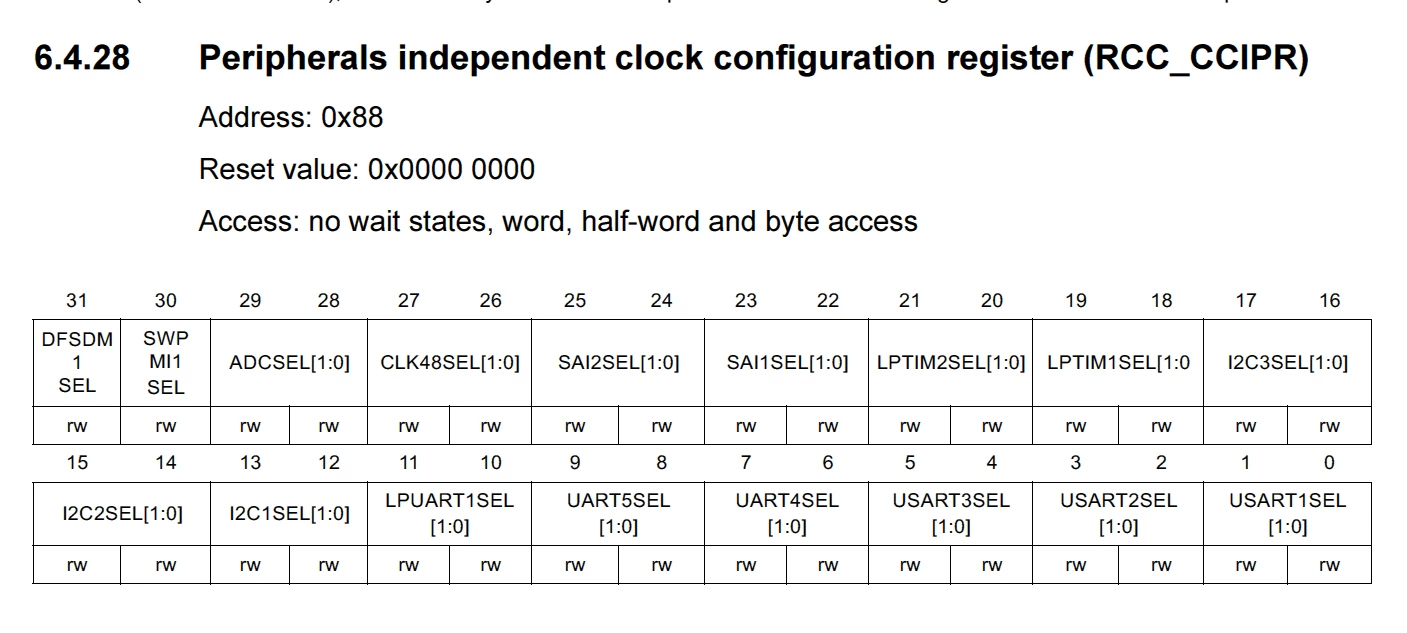

ok, set registers...RCC_CCIPR -> ADCSEL 2b

Thank you its there indeed. Boy... I wasted a lot of time looking for that register. Maybe I'll use the Cube next time :)

Cube (more precisely, CubeMX) won't tell you where that register is, either. You are supposed to click and trust :)
