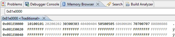

I modified it to erase the last sector of the STM32H747I MCU's flash (Bank_2.Sector_7) and program 8x32-bit words.

HAL_FLASH_Unlock();
SCB_DisableICache();
if (HAL_FLASH_Program(FLASH_TYPEPROGRAM_FLASHWORD, SettingsAddress, ((uint32_t)FlashWord)) == HAL_OK)
 FlashError = 0;
HAL_FLASH_Lock();
SCB_EnableICache();
The example works great!.
Do I understand right that HAL_FLASH_Program() method programs 256 bits (8x32-bit or 4x64-bit words) at a time? In other words, I can't program a single 32-bit location of the flash.
Correct. Due to ECC, the entire flash page must be programmed and cannot be reprogrammed without erasing the sector the page is in.
