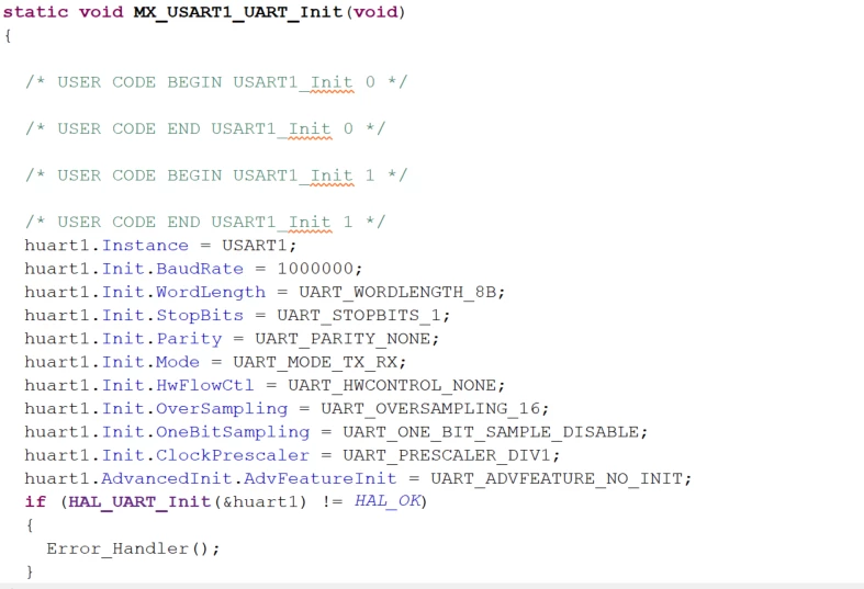

I am having problem with uart on stm32h755, nucleo kit.
I use uart1 and uart2 to communicate with each other using DMA.

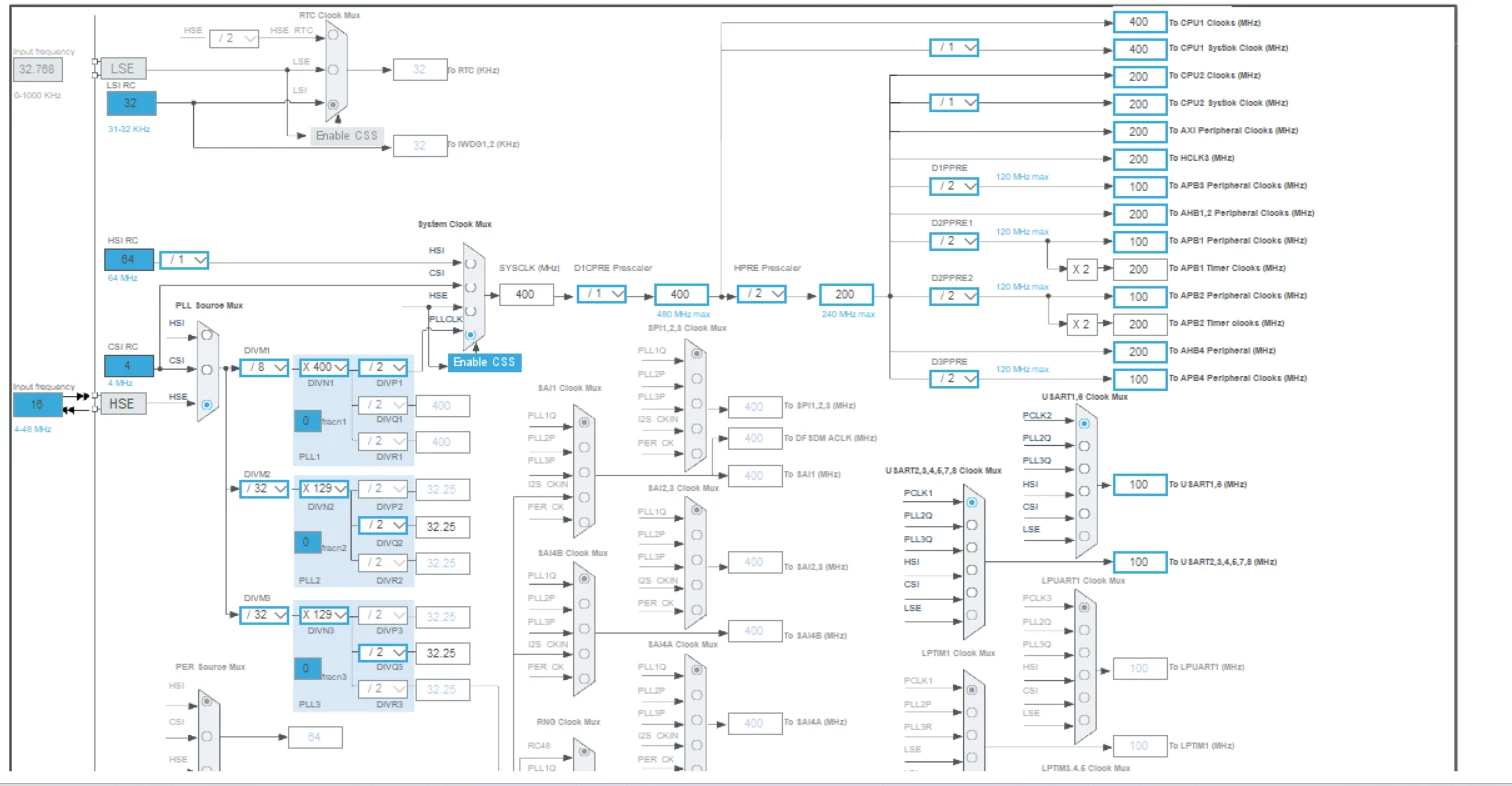

When I set the baud rate above 1M baud rate it doesn't work. Below is the clock configuration.Screenshot 2024-01-20 224149.png

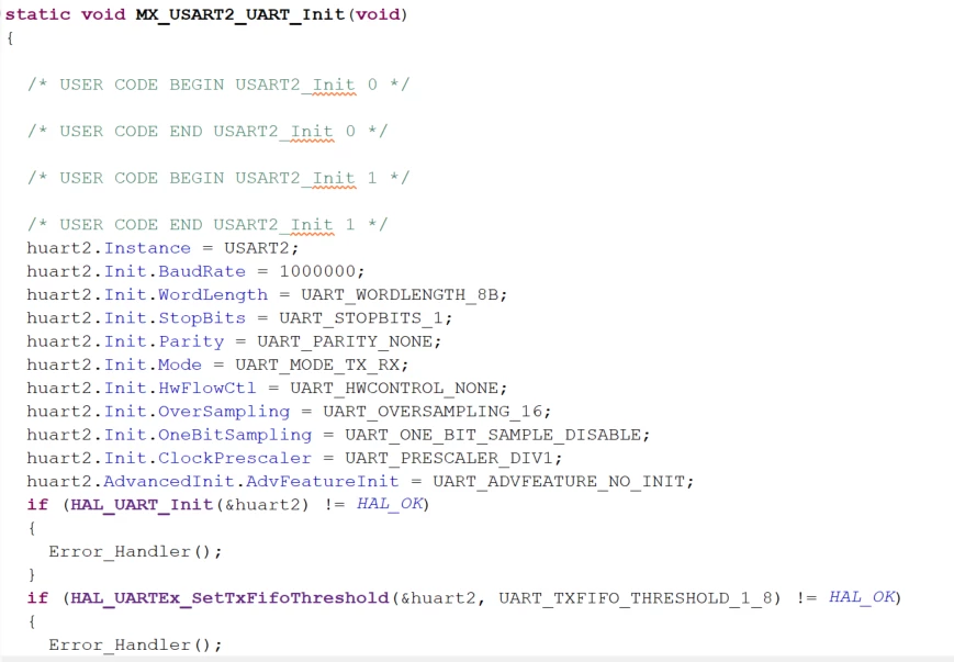

And here is the UART configuration.

How does "doesn't work" manifest?
The receive is problematic? The transmit? Over / Underrun?
If you transmit a constant 0x55 ("U") pattern, can you check the frequency with a scope?
As the rates increases the frequency error can get larger / rougher. You want a bus clock that's closer to a multiple of 16 MHz for 1 MHz, in 16 Over mode.
If using RS232 level shifters, these have bandwidth limits around 1 Mbaud.

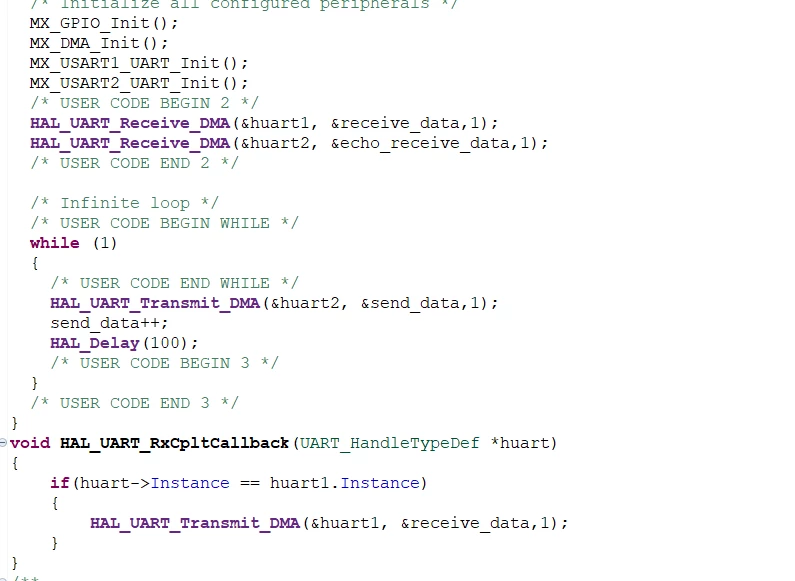

I just transmit from UART1 to UART2 and transmitted back.
Below is the code that performs the transmission and reception.
The problem is when I increase the baudRate to 2M the variables send_data, receive_data, echo_receive_data do not change. When I set the BaudRate to 1M, the variables change, proving that the UART is working.
