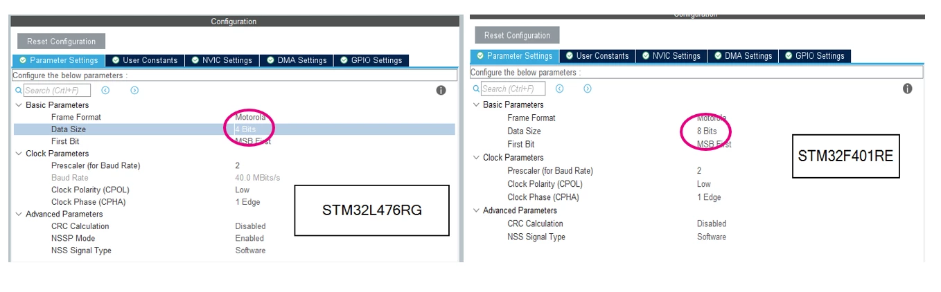

The NUCLEO-PGEEZ1 should be compatible with the L476RG as the F401.
Did you check the data size in the SPI parameters setting (CubeMx) than can be different from L476RG and F401 ? Please see the image attached.
I'm not sure it's going to solve your problem but I think a quick check is worth it.

Thank you Thomas for your answer. You have mentioned about data size, that was the first what I checked,after I saw, that it didnt work, it didnt help - please see the image attached.

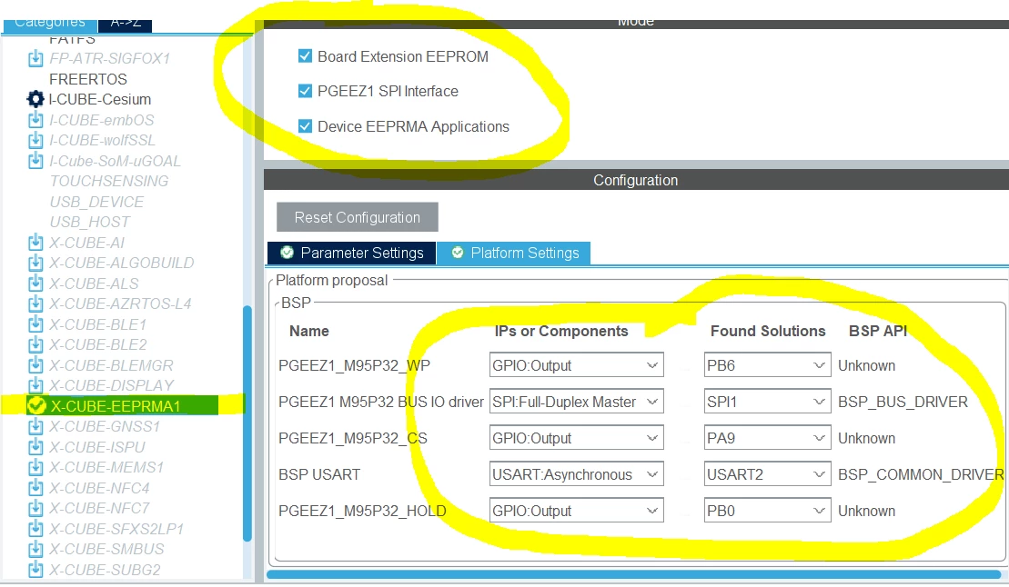

So, going further, let me explain, what problems happen, when you are going to focus on L476 board.
There are two scenarios (with connected X-NUCLEO_PGEEZ1 to NUCLEO L476):

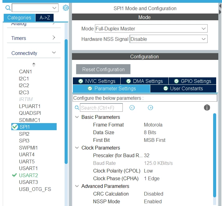

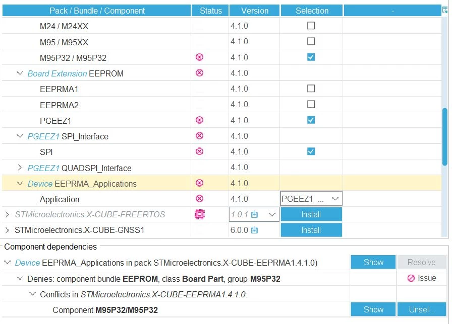

  1. You are launching STM Cube IDE, next you chose bord L476 in board selector, and init all in default mode. Next, you are going to X-CUBE-EEPREMA1, where first proplems appear. Look at the photos.
_legacyfs_online_stmicro_images_0693W00000bkLm1QAE.pngand now - after setting the SPI2 and GPIO's, it everything looks linke that:
_legacyfs_online_stmicro_images_0693W00000bkLlIQAU.pngSo -there is no way to use PGEEZ1 in proper way.

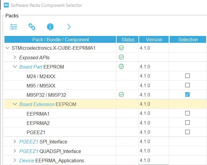

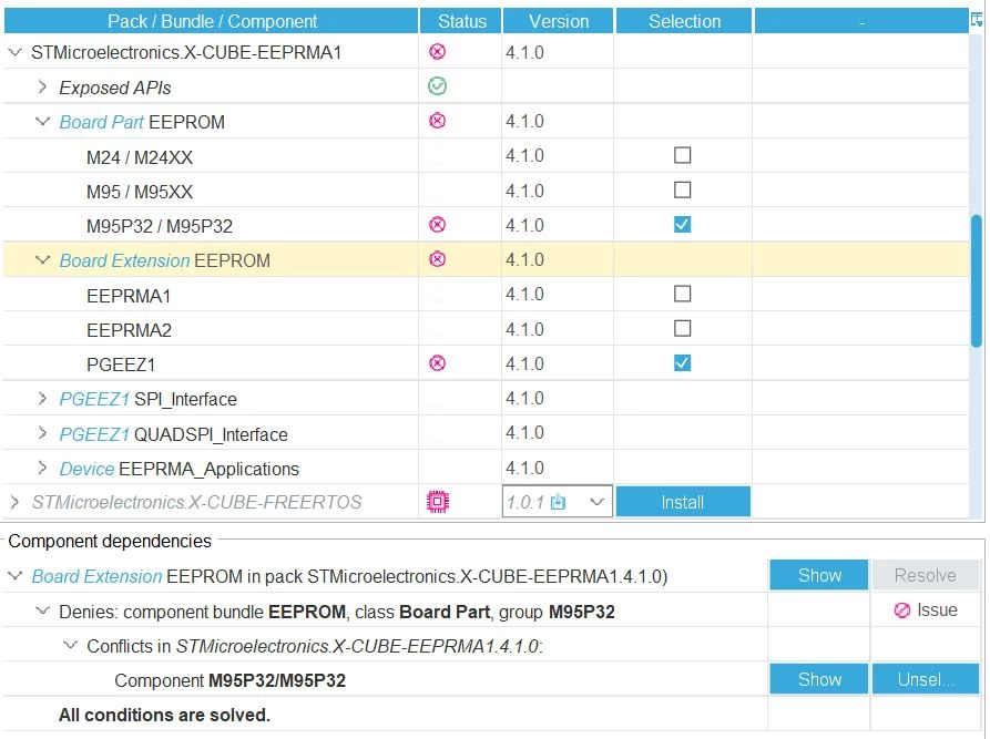

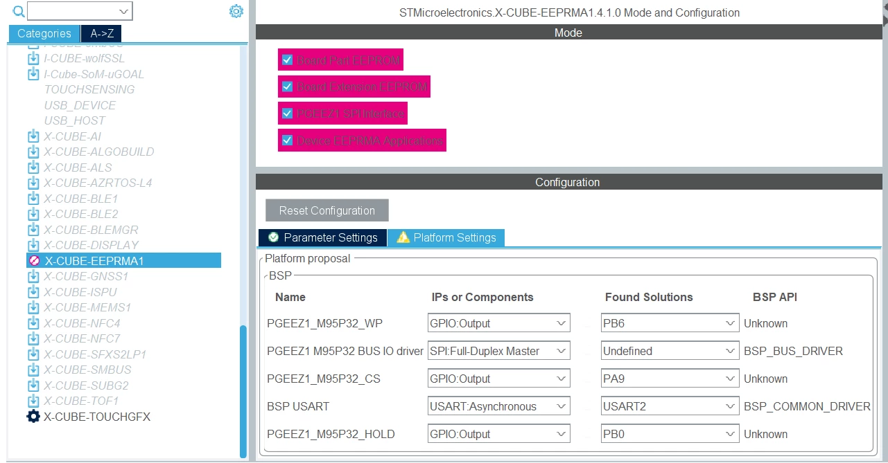

.2. And now second aproach. First - after chosing the microcontroller L476 (not Nucleo, because in Nucleo we have PA5 GPIO acting as a LED, on F401 is also LED connected to PA1, but the github example runs correctly) board and initalising everything, we don't go directly to X-CUBE-EEPREMA1 in Cube, but first - we set up SPI and GPIO's:
_legacyfs_online_stmicro_images_0693W00000bkMBLQA2.pngthan we go to X-CUBE_EEPREMA1 and we see, that also this time nothing can be configured, there are still errors.:

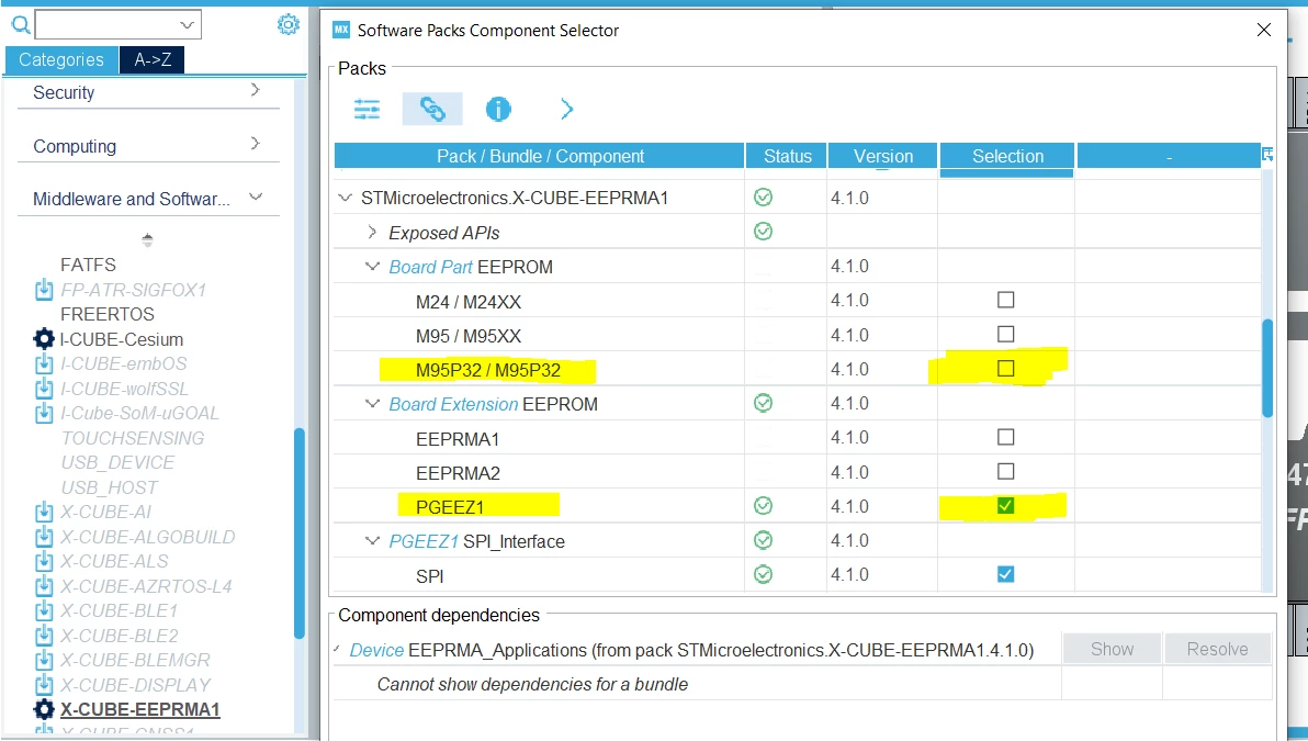

but if we will unmark Board Part EEPROM--> MP95P32/MP95P32 option, and mark only Board Extension EEPRM--> PGEEZ1 option, we will see green signs, that everything is ok:
_legacyfs_online_stmicro_images_0693W00000bkMEyQAM.pngso we might think, that probably everything should go right, after cofiguring nessesary things in PGEEZ1:
_legacyfs_online_stmicro_images_0693W00000bkMHOQA2.pngBut after running the code (no errors), we see that on the USART2:

TLLAM.1
May 22, 2023 3:54 PM UTC
Hi Paul
The software development team was able to run the NUCLEO-PGEEZ1 on STM32L476RG NUCLEO board.
Please find attached a PDF file for the STM32CubeMX configuration.
Do you mind following these steps and run the project ?
Thanks
Thomas
PDobr.1
PDobr.1Author
May 23, 2023 8:21 AM UTC
Your answer solved the problem. I must admitt, everything I did before, was almost right. I didn't put the PA5 to reset state (first mistake), and the settings of PA9, PB0 and PB6 was a little bit different (3rd column, there was Low instead of High). And the "GPIO OUTPUT LEVEL" column was the cause of problems, after changing it to "Low" - the project doesn't run poperly. When I change that parameter to HIGH, everything is fine.
Also, another lesson to learn, thank you for helping me and hope, next user with the same problem will read this thread and use the info.

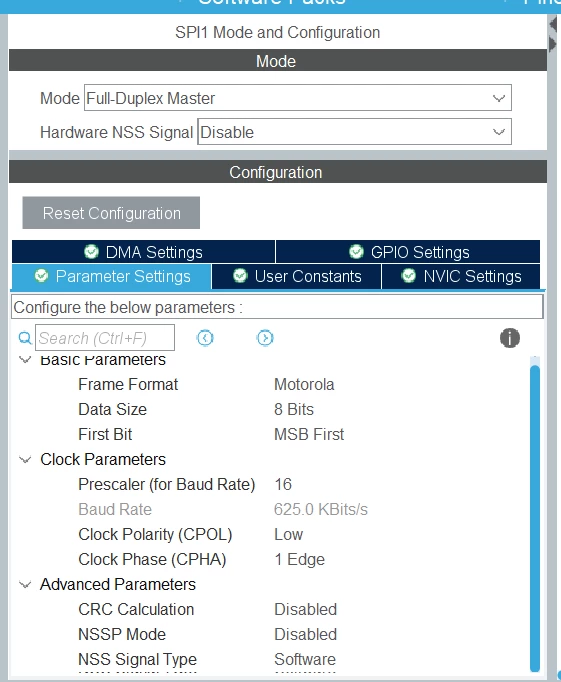

Hallo again. I hoped, there will be no more problem with M95P32, but there is one issue, that is worth to mention.
After some simple tests, suddenly the PGEEZ1/M95P32 stopped to respond. Right now the situation is the same, as at the beggining - its a big suprise for me and I cant find a solution. So, below is terminal copy of current state:
    ______Test 1 Starts______
    Test case to verify Write Enable and Write Disable
00   : Passed
00   : Failed
00   : Passed
    **************Test 1 Passed**************
        ______Test 2 Starts______
    Test case to verify Page Write and Read
 Write Page               : Failed
    **************Test 2 Failed**************
There were no electrical changes between states, when the board was working properly and now, when the board is not responding. There were also not significiant code change.

TLLAM.1
May 25, 2023 12:13 PM UTC
Hi Paul,
First I don't catch why you have the MX_SPI1_Init() and the MX_EEPROM_Init().
The SPI inteface is already initialized in the MX_EEPROM_Init().
Do you have an other device on the SPI bus to use the MX_SPI1_Init()?
Secondly, when I look at your for loop :
for (i = 0; i<1000; i++) PGEEZ1_M95P32_WritePage(0, data_buff, i, 512);
You are currently writing 512 bytes at address 0, 1, 2, 3... instead of writing at address 0, 512, 1024, 1536..
So you should loop like this to write 1000 pages:
for (i = 0; i<1000; i++) PGEEZ1_M95P32_WritePage(0, data_buff, i*M95P32_PAGESIZE, M95P32_PAGESIZE);
The M95P32_PAGESIZE variable is defined as 512 in the software package
Finally when the M95P32 stalls you have 3 possibilities :
Software reset
Deep power-down enter/release
Power-down/up
One one these three actions should bring back the device in a reset state as detailed in the datasheet (page 13, Section 4.9 Device Reset)
I hope this will help
Best regards,
Thomas

Ok - now I'm preparing a project for using both: NUCLEO F476 and PGEEZ1, and I will send it to you as a attachement. The code contains init for i2c1 and usart3 . The project should be zipped as attachement in my message.
According to the documentation:
Chapter 1 page 3 line 6 says:
The devices offer two additional (identification) 512-byte pages: • The first contains identification data and, upon request, the UID. • The second can be used to store sensitive application parameters, which can (later) be permanently locked in read-only mode.
Chapter 2.2, page 6 says:
The device offers two additional (identification) 512-byte pages. The first contains identification data and, upon request, the UID. The second page can be used to store sensitive application parameters that can (later) be permanently locked in read-only mode.
Mybe there is a clue?
After making again the project, I see it still doesn't work.
The terminal shows:
00   : Passed
02   : Passed
00   : Passed
 Write Page               : Failed
The jumpers are ok, according to the chapter 2.5 "Board Setup" page 4 in UM3096. The boards (both PGEEZ1) are still useless.
TLLAM.1
May 25, 2023 1:49 PM UTC
Hi Paul,
Just want to check : I have edited my message and maybe you only saw the first one if you answer by email. I had a comment about your loop code, please have a look.
Maybe the try to write to "higher" page (above 8192) will cause such problems
==> No there is an rollover.
I'm going to check your code.
So if I understand correctly, the M95P32 is not working even if flash the firmware and start a project from scratch ?
Thomas
PDobr.1
PDobr.1Author
May 25, 2023 1:53 PM UTC
The M95P32 is not working even of I use fresh software from scratch.
