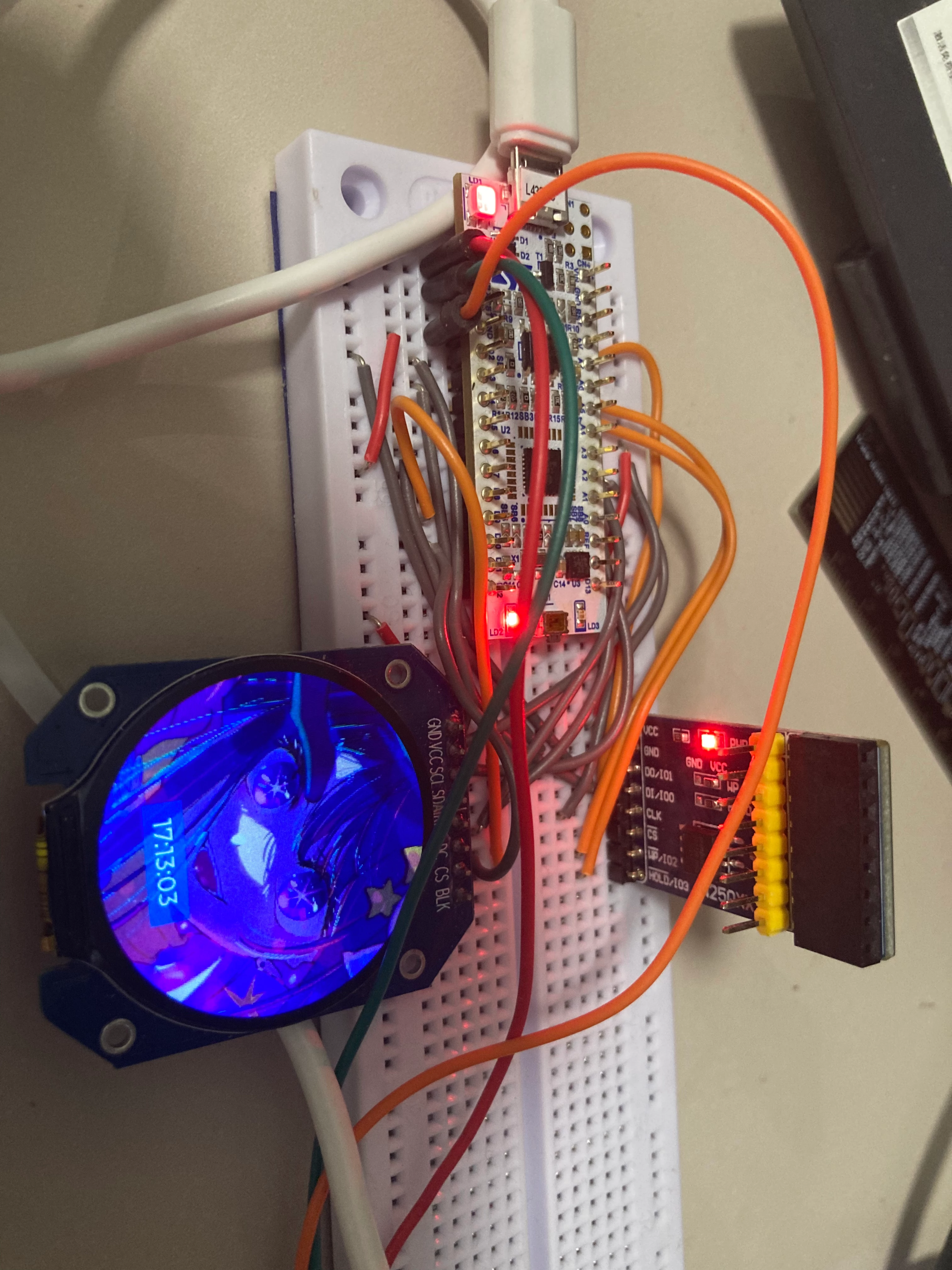

Recently, I was planning to use NUCLEO-L432 to create a smartwatch, but I encountered a fatal problem: running a program using external FLASH can cause the program to freeze.
Because I wanted to use LVGL as a graphical interactive interface, the 256K FLASH of L432KCU6 was not enough. Therefore, I used only burning bootloader on the chip and running the program saved in W25Q128 through QSPI. Due to limited funds, I have adopted the FLASH module, which has led to many strange problems (possibly due to non PCB wiring).
When I set the main frequency to 80MHZ (maximum), the program can only run for 16 minutes and will freeze; It can run for 40 minutes at 70MHZ; It can run for 60 minutes at 60 MHz, and the time of each stuck is the same. And since I divided the project into bootloader and app, I don't know how to debug my app program, so I don't know exactly where it got stuck.

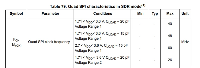

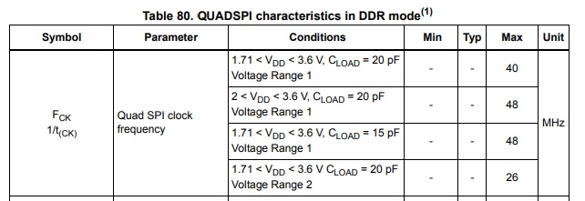

Hello @煜 张​ and welcome to the community  ,
Please note that the QUADSPI controller which connects the W25Q128 is limited to 60MHz in SDR, 48MHz in DDR mode as shown in the below figures (DS11451).

June 9, 2023
Thank you for your reply!
In fact, I never knew there were any requirements as shown in the picture. Thank you for telling me, otherwise I would have abandoned this project.
I am using a 3.3V power supply, and I am not sure what the C Load and Voltage Range in the picture are. However, to ensure normal use, I have set the global clock to 48MHz (now I am worried if it may be too slow or if there is any solution to speed up the operation). There should be no problem now, so I plan to run all night to see.

_EFrie
Senior
June 9, 2023
This will never work on a breadboard. QSPI is a high integrity required signal, you are probably on the edge, and all it takes is a little bounce, and boom, the MCU brains got scrambled.

June 9, 2023
Thanks for your reply.
The Breadboard is really inferior to the PCB board. I was unable to read FLASH with 4-wire jumper connection at that time. It was not improved until I replaced the jumper with a better copper wire and switched the internal high-speed clock to the external high-speed clock:grinning_face:
_EFrie
Senior
June 9, 2023
Or I could add, won't work as shown. Maybe if you lower to 5mhz and put resistors in the right place it could help, but as a whole QSPI signals have to be watched carefully.
noob
noobAuthor
June 9, 2023
I am using the ST official development board, and there should be no hardware issues. I have now lowered the global clock to 48MHz and have been running for an hour without any issues. I am planning to run it all night. Although it can be used, I am still worried if 48MHZ will be too slow.:face_screaming_in_fear:
