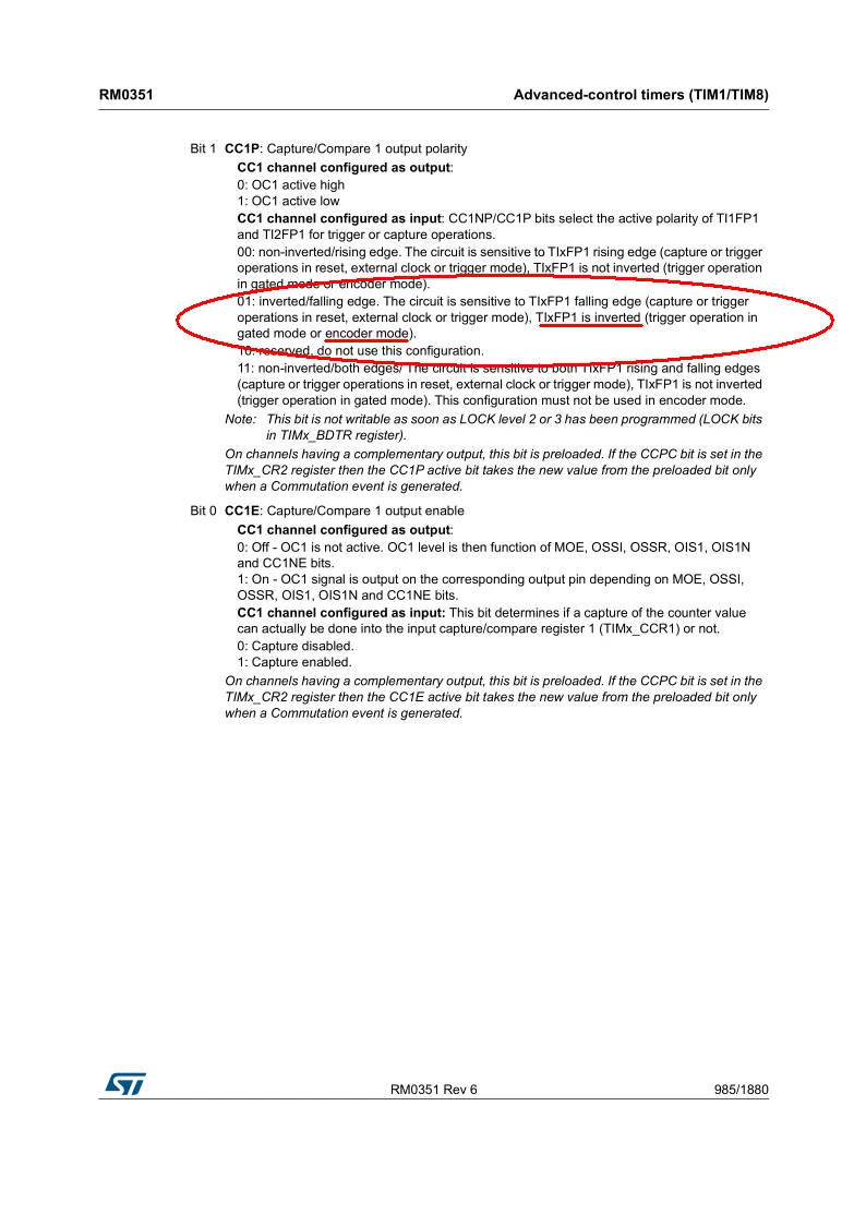

I'm using an STM32 to control a DC motor with a dual hall encoder feedback.
To monitor motor position I want to use a General Purpose Timer (16bits) in Encoder Mode.
The configuration is going well but I notice that the logic is reversed:
  • When the motor is going forward, the TIM Counter goes down.
  • When the motor is going backward, the TIM Counter goes up.
I could fix this issue by flipping the wires, but I would prefer just changing a HAL configuration. Using CubeMx I tried to change the count direction settings without success (the behaviour stayed the same).
Is there a way to flip the timer counter logic?
Your help is appreciated.
Best answer by waclawek.jan
Change polarity of one of the channels, using TIMx_CCER.CCxP.

Hi @Community member​
Thanks for your answer.
It worked perfectly.
I'm not sure I understand why it worked though. I don't see how switching channel 1 to Falling edges would reverse counting.
If you have any resources to learn about it, let me know.
Regards,
Gabriel
waclawek.jan
March 1, 2022
It inverts the whole signal, thus rising edges become falling and falling edges become rising.0693W00000Kb3COQAZ.png
