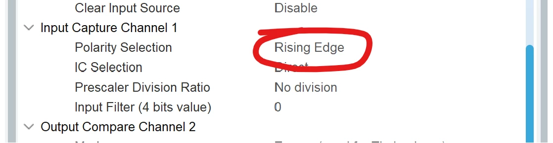

A little hard to decipher the behavior you want here. Perhaps a diagram would help.
You want CH2 to go high a set period of time after CH1 goes high? And then an indeterminate amount of time later, you want CH2 to go low after the same period of time as before after CH1 goes low?
IC polarity is selectable in CubeMX.

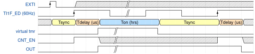

Yes, it's hard to explain, so I found a diagram tool and came up with this:
  • The external int starts the sequence, but I am using the slave trigger mode to synchronize the actual start of the timer with the edge at TI1F_ED. This is Tsync which is variable
  • Then output compare at CH2 sets the OUT active. This gives the fixed Tdelay in us
  • Due to the large difference in time, I'm just implementing a virtual timer in memory to handle setting the output to inactive
  • This is where I need to re-trigger the timer so it only starts once the edge is detected at TI1F_ED and the Tsync, Tdelay sub-sequence can be restarted
  • Right now, it simply runs for Tdelay without waiting for re-synchronization with the TI1F_ED
  • the CNT_EN represents how the timer enable is set. Obviously this is just an implementation detail that could be changed
