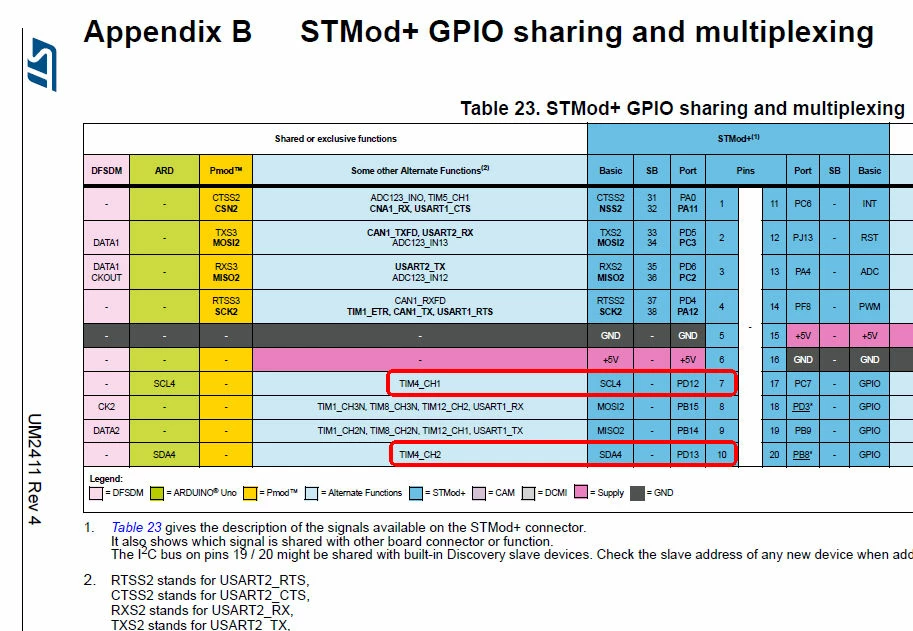

How to reset STM32H7 timer/counter and how to set the encoder mode?
I am new with the STM32H7 timer/counter. I found the LPTIM_PulseCounter example which was good starting point. But I have a couple of questions:
  1. How can a reset the counter manually (not via automatic reload) of LPTIMER1? I could not find any HAL_LPTIM_CounterClear(), HAL_LPTIM_Counter_Reset(), HAL_LPTIM_Counter_Write(0x0000) function in HAL LPTIM Generic Driver.
  2. As far as I think the LPTIMER1 is capable to count quadrature encoded signals. It has two inputs, I can set the ENCODER mode and I can start the encoder mode with HAL_LPTIM_Encoder_Start (LPTIM_HandleTypeDef * hlptim, uint32_t Period) function. But I guess the period parameter should be set to 0xFFFF in order not to allow autoreload function after PERIOD count.
  3. Does ENCODER mode work with 32-bit timers? No need to be LPTIMER.
  4.  I have STM32H747I-DISCO board. The input1 of the LPTIMER1 is in the Arduino connector PD12 (pin 10 of CN5). Is the Input2 of LPTIMER1 in the same CN5 connector but the next pin: pin 9 of CN5 (PD13)?
  5. Is there any example how to use LPTIMER1 as an encoder in STM32H747I-DISCO board?
Thanks for your help!
Louis

Thanks for the suggestions. The STM32H743I-EVAL (Single core version of STM32H7474I) LPTIM_Encoder example project was the closest example to me (how to configure Encoder Timer/Counter). The exmaple used LPTIM1 for encoder but I had problems with accessing to the defined INPUT1 and INPUT2 pins of LPTIMER1 in 747I-DISCO board. In the example the LPTIM1_IN1 = PD12, and LPTIM_IN2 = PE1 port pin. In STM32H747I-DISCO board the PD12 pin can be found in the STMOD+ pin7, which is accessible from the little “fanout�? board. The LPTIM1_IN2 = PE1, but I could not find PE1 nether in ARDUINO not in the STMOD+ fanout board. So, this example cannot be directly used.
However I found (in the STM32H747I-DISCO user manual) that the STMod+ fanout connector has PD12 and PD13, which is the INPUT1 and INPUT2 of TIMER4. The TIMER4 is 32-bit counter and does support Encoder. Great, I just need to use TIMER4 instead of LPTIMER1. It seemed not to difficult job. (See attached file)
Now the problem is if a use STM32CubeMX with a new project for STM32H747I-DISCO board and if I enable TIM4 (for CM7 core) then it specifies different pins for TIMER4 in Encoder Mode, other than the STM32H747I-DISCO user manual… For TIM4 IN1 CubeMX specifies PB7 (instead of PD12) and IN2 = PD12 (Instead of PD13). I feel disturbance in the Force. Which is right?
Thank you for your help.
Best regards,
Louis
Jul 26, 2021 1:51 PM UTC
TIM4_CH2 is an option for both PB7 and PD13. If you want to change it to a different pin, click on the pin and select TIM4_CH2.

Hi TDK!
Thanks, nice idea and even it works!
However, there should be a cross reference table which shows the PIN numbers and its function(s)/alternate functions. And reverse: a cross table which shows (for example) TIMER4_CH1 can be assigned to the following GPIO pins. Do you know where can I find these tables? I could not find in the STM327H7xx manual.
Many thanks for your help

Jul 26, 2021 6:02 PM UTC
The datasheet will have that info.
