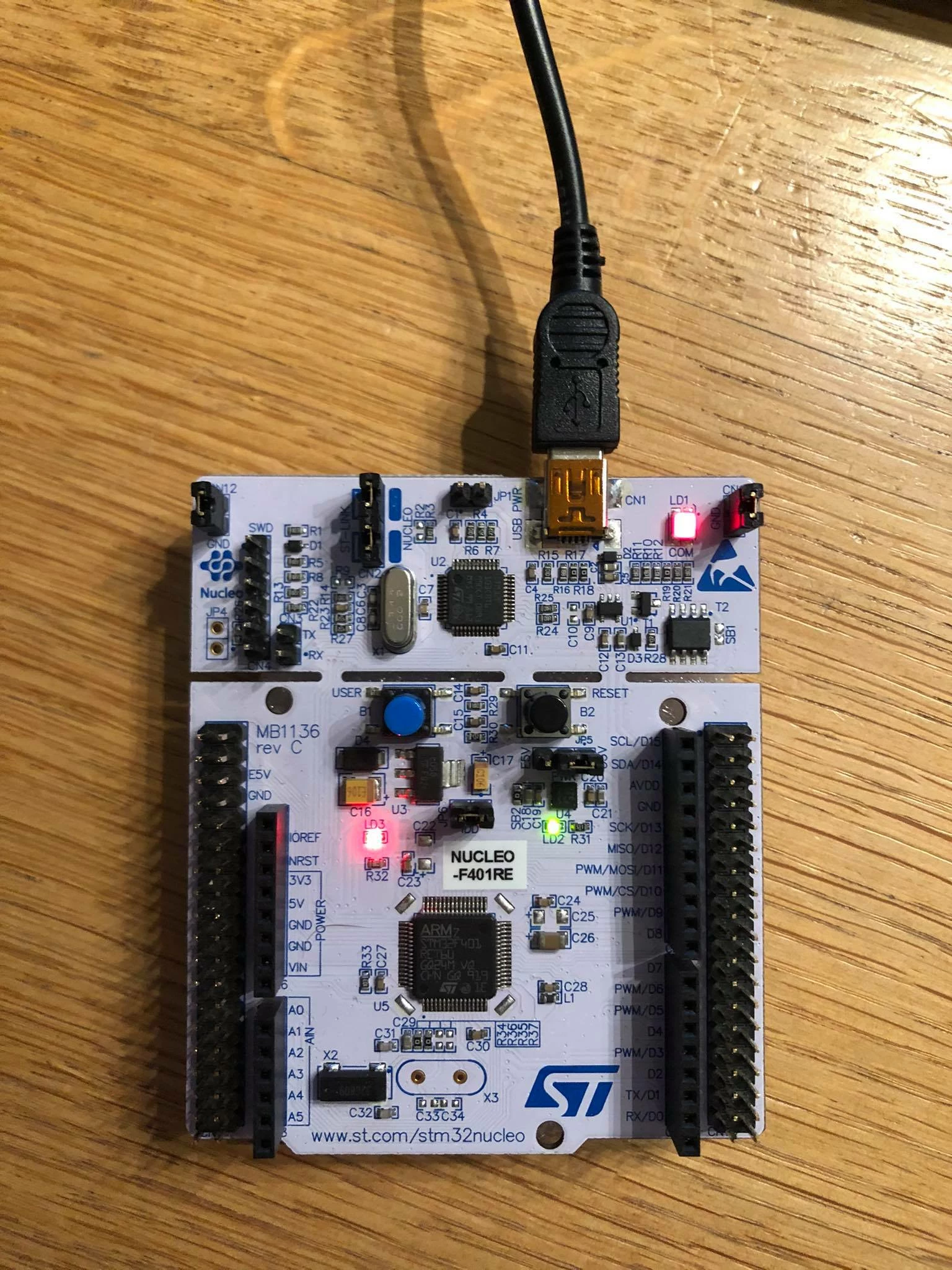

Hello everyone, I'm new on STM32.
My Board is blocked in this state (see on the photo) : 2 led at red state continuously.
And when I try to load program in the board, this type of erros occured : Error launching GDB server.

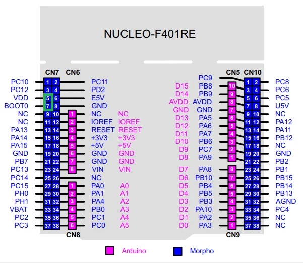

Review the board manual, there are diagrams and schematics. There are a couple of spare jumpers attached to board, see upper top right and left.
Short the VDD and BOOT0 pins with said jumper. Puts the chip into loader mode, not running your code, that's probably bricking the board
Power cycle, remove and reapply power to the board via the connector.
0693W000008GDZSQA4.jpghttps://www.st.com/en/development-tools/stm32cubeprog.html

Jumper BOOT0 to VDD, reset or power cycle the board, and try connecting / erasing with STM32 Cube Programmer directly.

Sorry but where is the jumper BOOT0 ? And wath do you mean by power cycle the board ?
