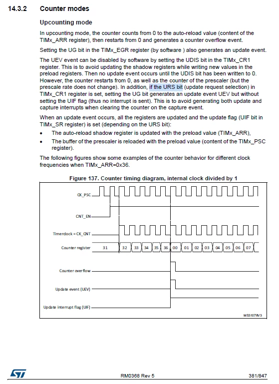

I tries the macro to reset the counter, or even setting the UG bit in the  TIMx_EGR register.  I tried also to play with
URS and UDIS as reported here:
How to reset STM32 timer? - Stack Overflow
and in the in the reference Manual RM0368 (check in the Attachements).
I really don't undestand  if UDIS have to be = 0 or 1 if I want to restart the timer without any interrupt to arise.

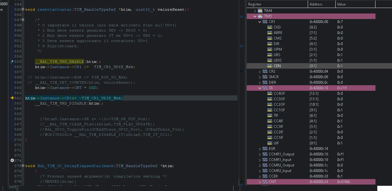

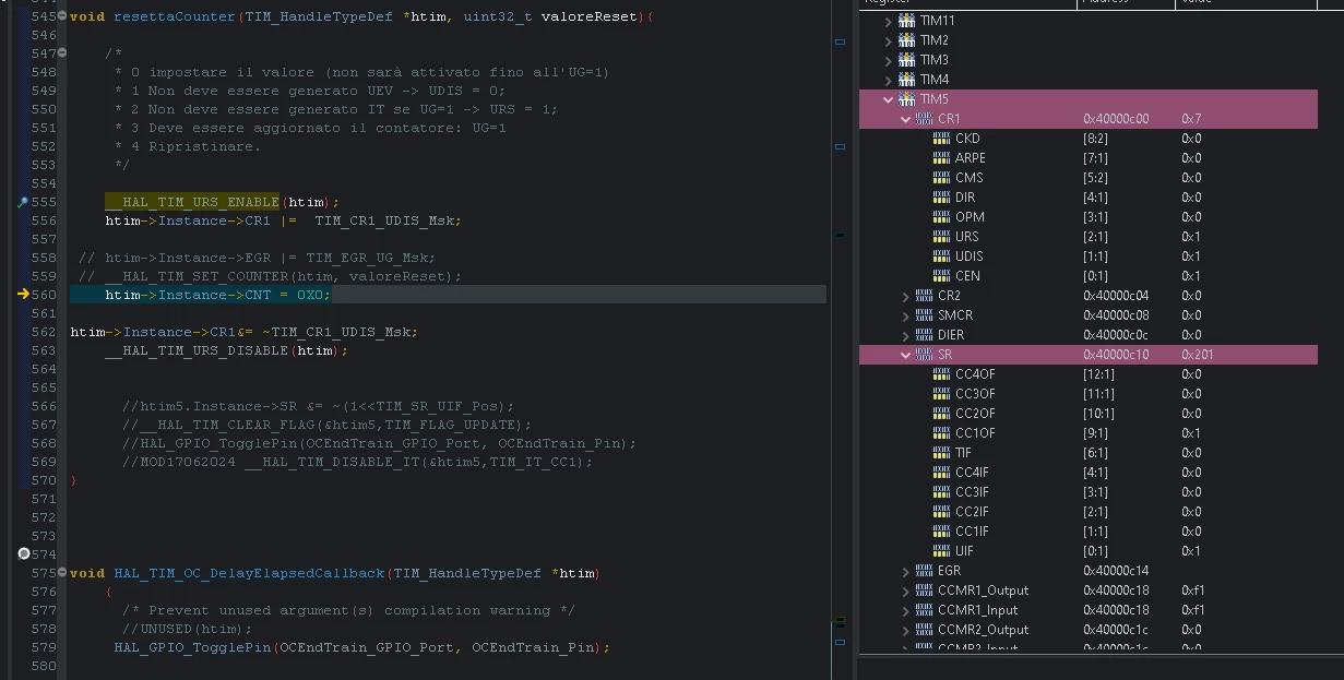

Here my code.
void resettaCounter(TIM_HandleTypeDef *htim, uint32_t valoreReset){
	__HAL_TIM_URS_ENABLE(htim);
	htim->Instance->CR1 |= TIM_CR1_UDIS_Msk;
 //	htim->Instance->EGR |= TIM_EGR_UG_Msk;
 //	__HAL_TIM_SET_COUNTER(htim, valoreReset);
 	htim->Instance->CNT = 0X0;
htim->Instance->CR1&= ~TIM_CR1_UDIS_Msk;
 	__HAL_TIM_URS_DISABLE(htim);
When this code run Channel1 (IC function is still running). Channel 2 is stopped (OC function). When Channel 2 restarts the interrupt routine is launched.
I attached the snaphots of my debug before and after the counter reset.
Don't know why interrupt is still there since OC callback starts.

TIMx_DIER  -> UIF bit controls whether you get an interrupt when the update event happens
Bit 0 UIE: Update interrupt enable
0: Update interrupt disabled
1: Update interrupt enabled
But you need to enable the update event otherwise it will not update from shadow register.. so URS=0 to get the update event in case of setting ug=1
Bit 2 URS: Update request source
This bit is set and cleared by software to select the UEV event sources.
0: Any of the following events generate an update interrupt or DMA request if enabled.
These events can be:
– Counter overflow/underflow
– Setting the UG bit
– Update generation through the slave mode controller
1: Only counter overflow/underflow generates an update interrupt or DMA request if
enabled
