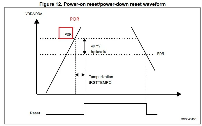

I find an error in the RM0090(STM32F4 Reference manual) as follows:
0693W00000GYHmEQAX.jpgBut I don't know how to report it. Please help me.

Hello @StudentWei​ ,
Thanks for having reported this typo.
I escalated this error internally for correction in the coming release of the RM0090.

MM..1
November 20, 2021
Maybe this isnt error. PDR is activated on botom value PDR and hold to hysteresis top value PDR. Any value more as top PDR start POR ...
