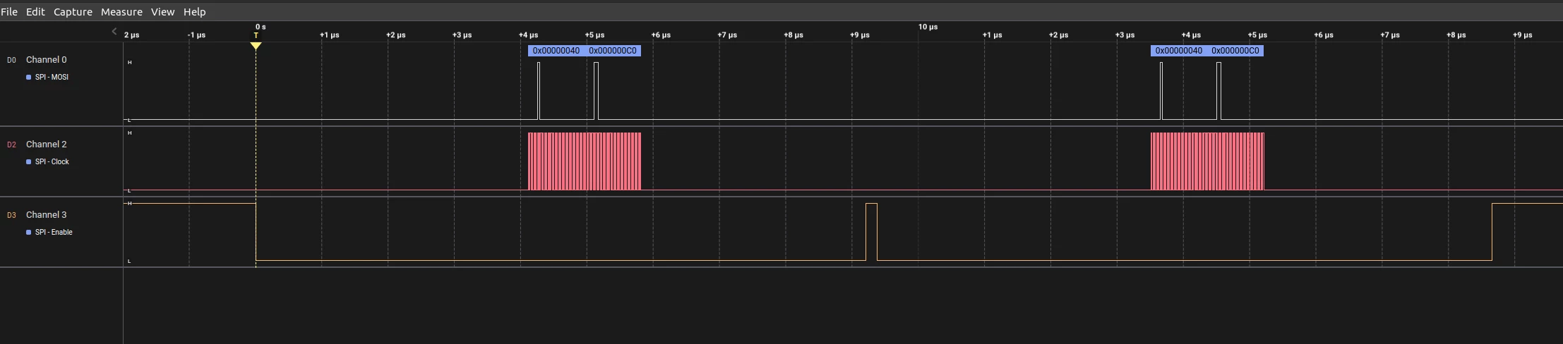

I need to transfer a large amount of bits over SPI de-asserting/asserting the select line very 64 bits. I'm using DMA. The time between transmissions is huge, as can be seen below:
The pink channel is SCK, each chunk is 64 bits. The code is below:

}How can I decrease this delay?
I have though that I could config. DMA to send all the data I have, but I need to generate a pulse in the SPI SS line every 64 bits. How can I do this?
