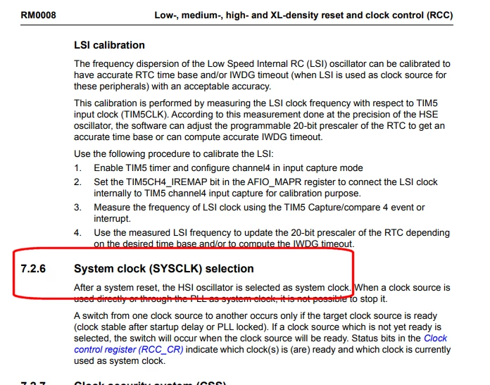

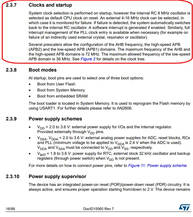

The datasheet will tell you what the default clock configuration is at startup; eg,
See also the Reference Manual:
So, of course, you can work it from there.

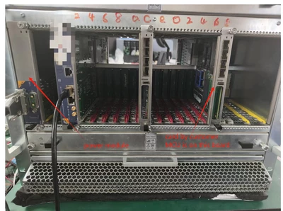

The commercial power system(to be specifically, it is a power supply made according to uTCA system and spec)has very limited 3.3V power supply.  And it has over current protection ~180mA. And when my board(3.3V powered MCU assembled on it) powered up, it easily triggered the over protection behavior. So I suspect the inrush current of 3.3V(mostly consumed by MCU) may cause this problem, that's why I post it here to find a way to reduce inrush current.

I have to say I'm testing the hardware system but without enough hardware detail design information of the power system and power module(no schematic, only user manual). I tried to contact the technical support from manufacturer but failed.
I could provide some answer your questions:
    decoupling cap for 3.3V about ~2uF
    No 3.3V soft-start designed
    No circuit to hold STM32 in reset until power supply is stable.
You mentioned to keep MCU in reset then applying power, it's good idea to give us right direction.
the last question you asked, I also want to know, but now only the original equipment manufacturer could answer this. I used some commercial system chassis and system as shown below:
Thanks.
