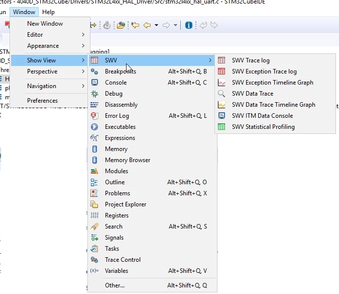

    Is there such an article for STM32CubeIDE?
    Now that I've migrated to STM32CubeIDE from Atollic TS, I can't get the SWV console to show printf messages.
    MFend
    July 26, 2019

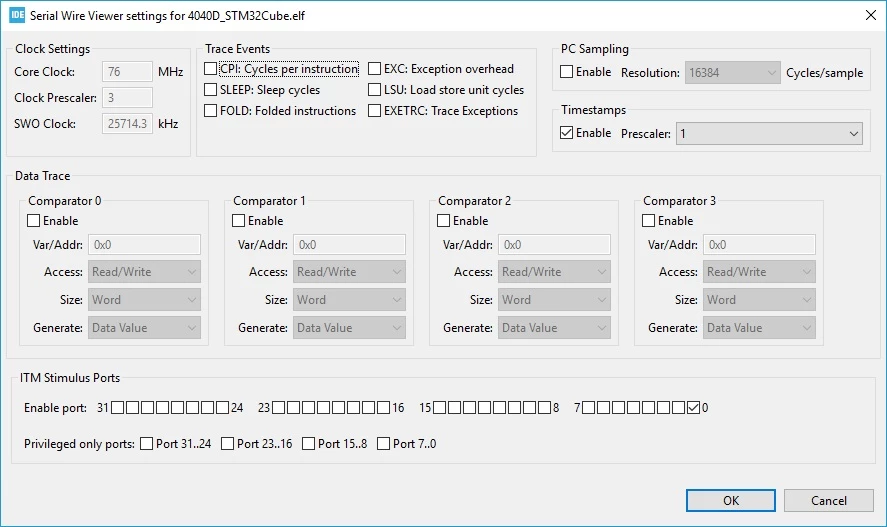

    The SWV ITM Data Console is working!
    In Debug Mode - choose Window -> Show View -> SWV -> SWV ITM Data Console
    When the SWV is opened, choose configure (wrench/screwdriver icon) and make sure that Hz rate is correct (can be set in Debug dialog when connecting with ST-Link or Segger-Link) - and check Port 0 (towards bottom of screen on far right - see attached.
