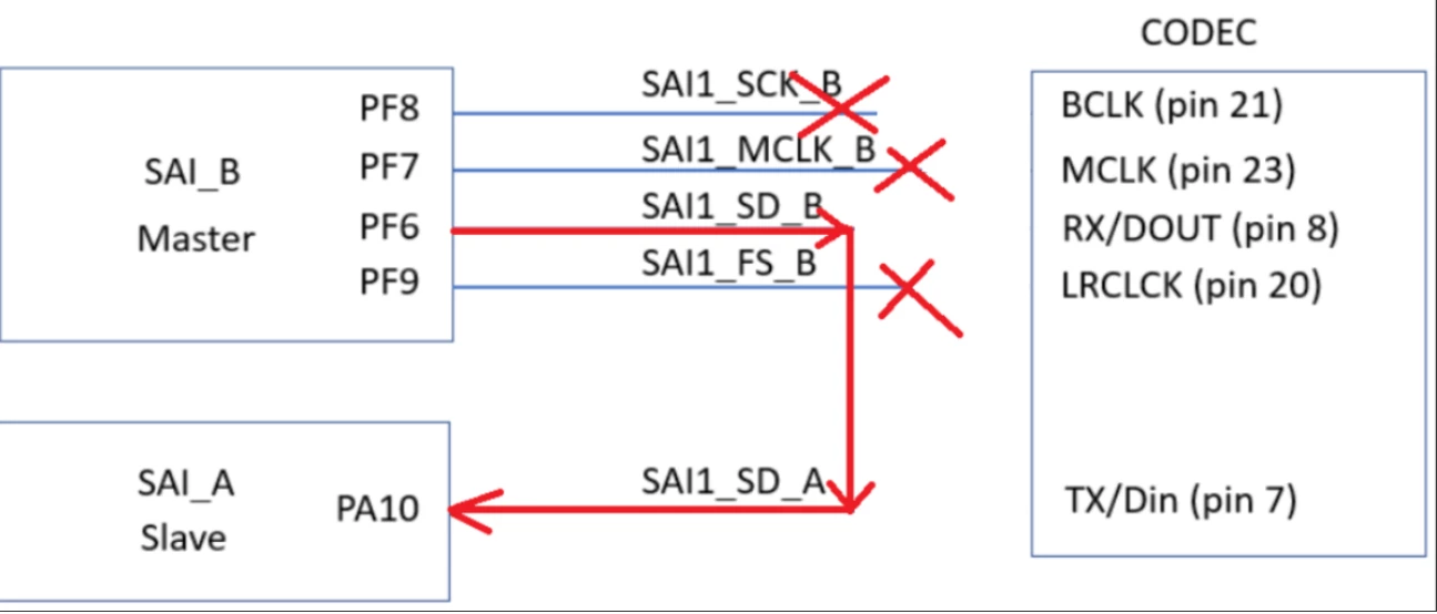

Thank you for this information but can you tell me how to implement it with an example code please ? In my case I just need about the HAL_SAI_RxHalfCpltCallback and HAL_SAI_RxCpltCallback, in fact my previous code works by simulation I looped the TX with the RX and I created 2 tables, one TX and one RX. But in reality the data comes from a CODEC and my STM32 only receives the data sent by the CODEC
int32_t playbuf[4096*2] __attribute__ ((aligned (32)));
int32_t playbuf_RX [4096*2] __attribute__ ((aligned (32)));
 for (i=0;i<8192;i++)
 {playbuf_RX[i]=0;}
 {playbuf[i]=i;}
Here is the summary of my diagram

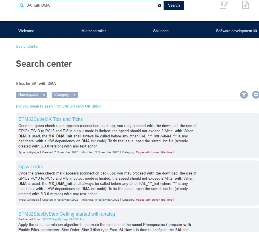

@TDK wrote:
There are plenty of DMA examples in CubeMX that illustrate this premise that you can go after given sufficient drive and motivation.
Plenty I trust you but when I go to CubeMX and type the keywords I only have 6 examples. And that's not what I'm looking for but thanks anyway.
