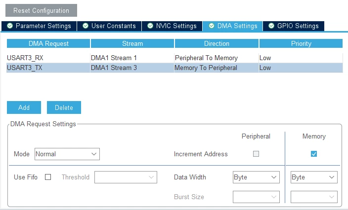

I suggest to use USART with DMA and idle line detection.
below is an example
uint8_t RxBuffer[256],RxLenght;
// in init
HAL_UART_Receive_DMA(&huart3,RxBuffer,255);
__HAL_UART_ENABLE_IT(&huart3, UART_IT_IDLE);

Hi @Muhammed G�ler​ !
Thanks for the screenshot and code, seems pretty simply and efficient. I'll give it a try and let you know about it.
