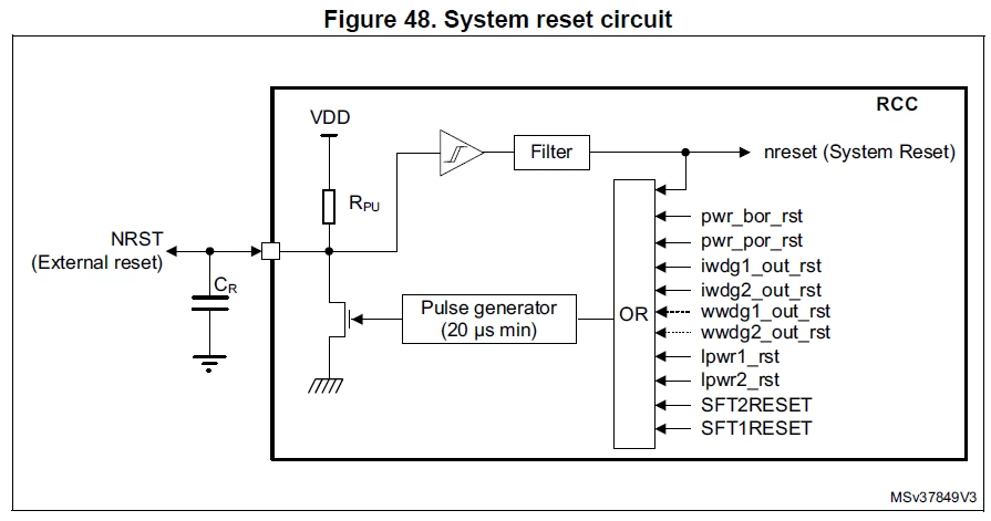

How to realize single core reset in stm32h745?
  • November 7, 2020
  • 1 reply
  • 702 views
For example: M7 program opens the watchdog, when the program enters hardfault, only M7 program is reset without affecting the normal operation of M4.
1 reply
November 7, 2020
A reset from any source pulls NRST low and does a full system reset. There's no way to use the watchdog to reset only the M7 core.
