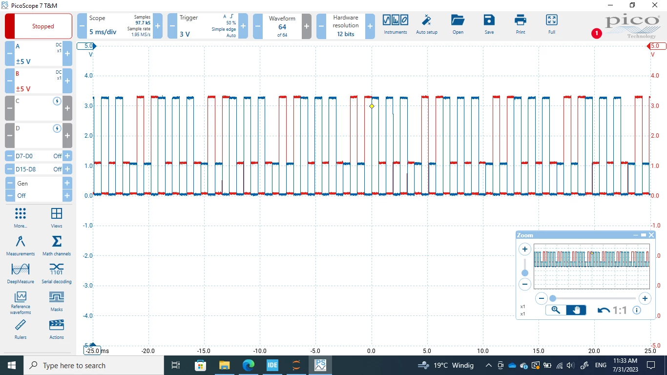

RShre.2
RShre.2Author
July 31, 2023
Hi Gwénolé,
This is what I am doing right now. As I learnt that getvalue doesn't actually do anything more than accessing the registers, I am not sure where the conversion is taking place.
void TIM2_IRQHandler(void)
if (TIM2->SR & TIM_SR_UIF)
HAL_GPIO_TogglePin(GPIOA, GPIO_PIN_6);
__HAL_ADC_CLEAR_FLAG(&hadc1, ADC_FLAG_EOS);
adc1 = HAL_ADC_GetValue(&hadc1);
DAC1 -> DHR12R1 = adc1;
adc2 = HAL_ADC_GetValue(&hadc1);
DAC1 -> DHR12R2 = adc2;
TIM2->SR = ~TIM_SR_UIF;  /* Clear all interrupts */
with this I get the following output,
where blue should be around 3.3.V and red should be 1V but i think the adc is confused between two different channels.
what is the pro of using a DMA instead of saving the value into a variable directly in the interrupt? I need to read adc values in real time to do further calculation so I am reading the adc inside the timer interrupt.
Btw, I have put the external trigger conversion source in adc (CubeMX) as tim2 which is my timer interrupt here.
July 31, 2023
