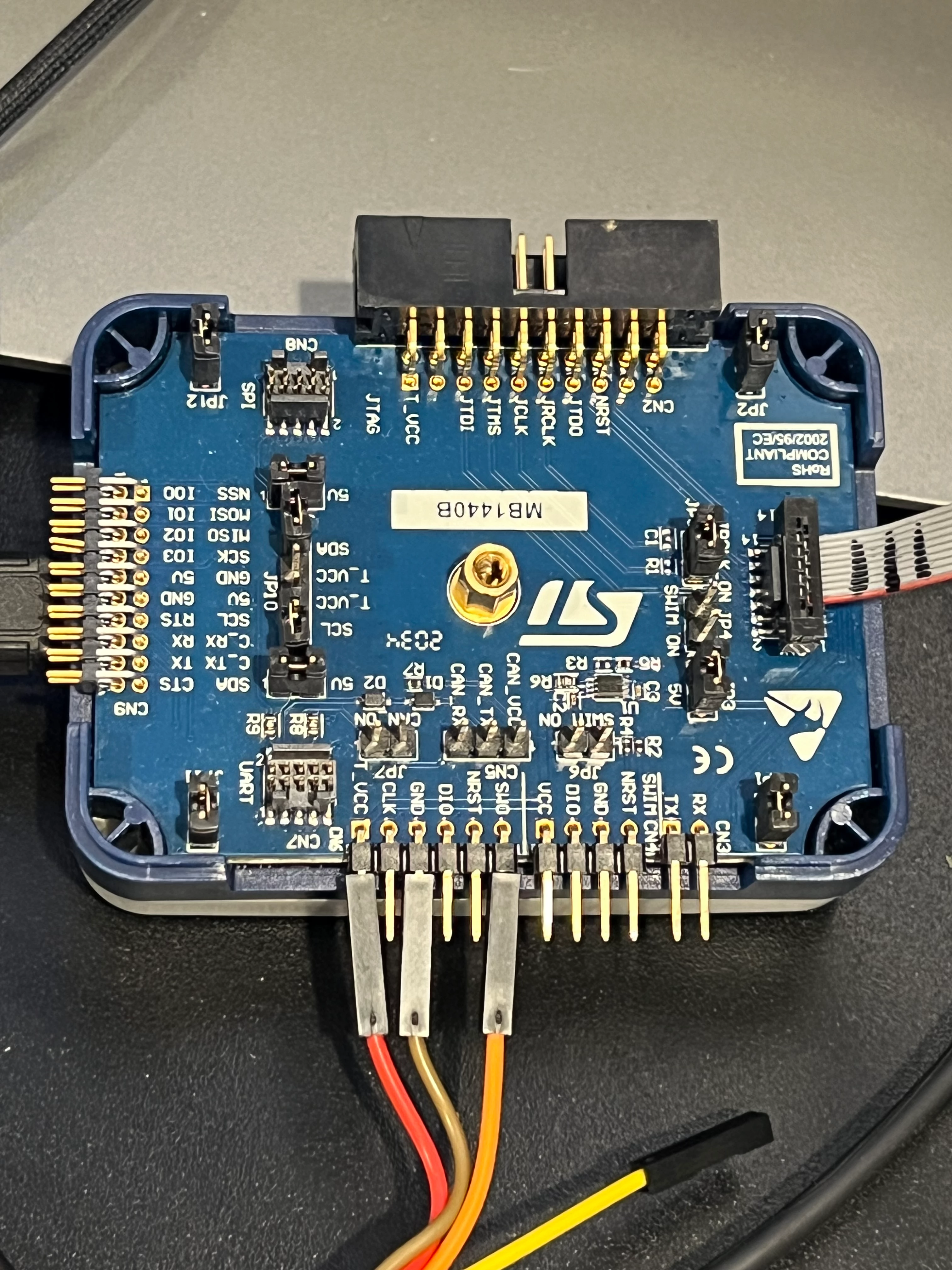

I was able to get the SWO connected to my FTDI pretty easily.  The ST-Link V3Set has the SWO coming out to a couple different pins so I hooked up my scope and found that my SWO data rate was 2M Baud.  Note that I am connected to a custom PCB with a STM32F427 with the SWO lined connected to the programming connector.

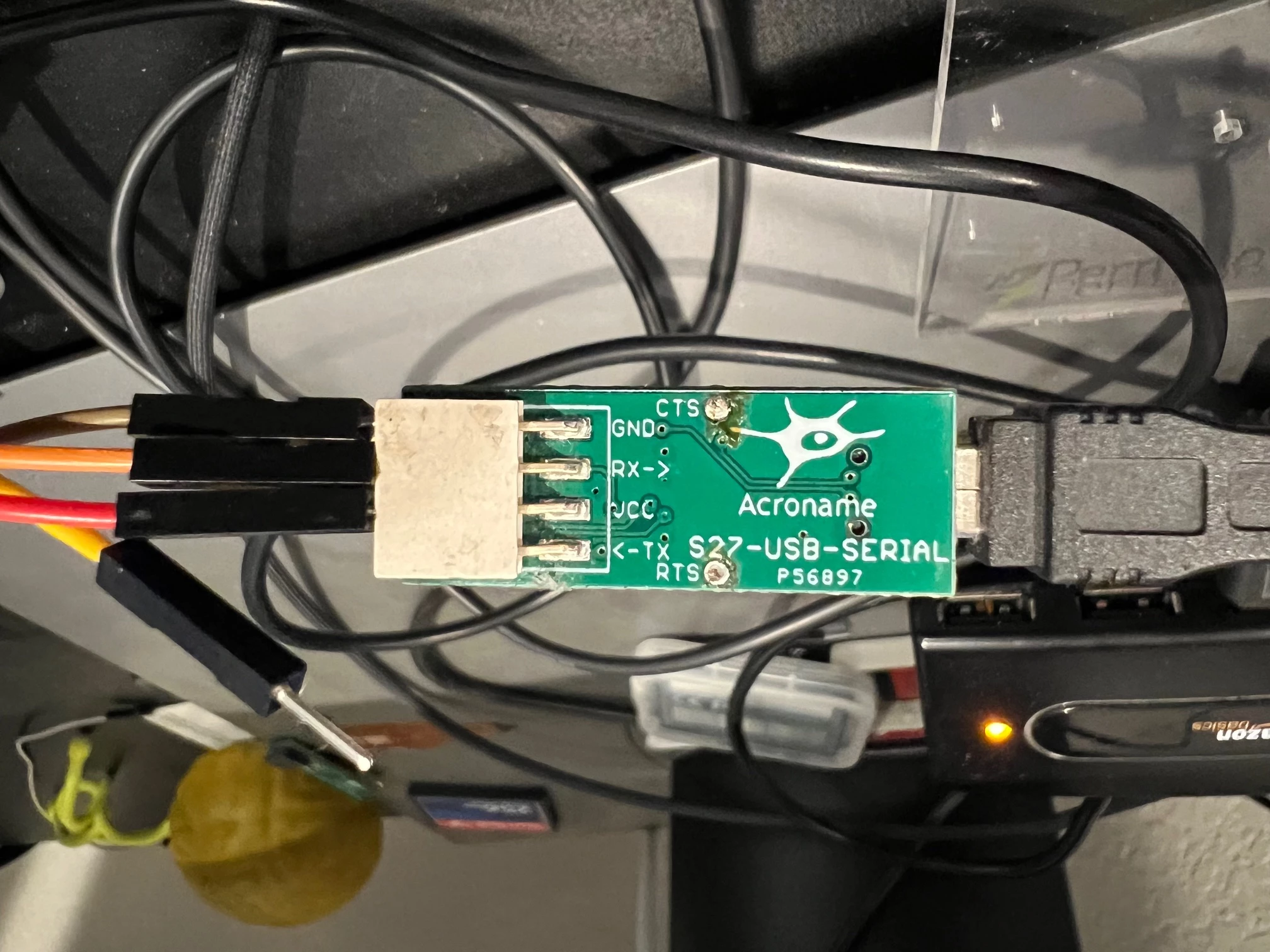

Once I knew the correct data rate, I simply connected the ST-Link's SWO, VCC, and GND:
to the brainstem(FTDI -> USB) like so:

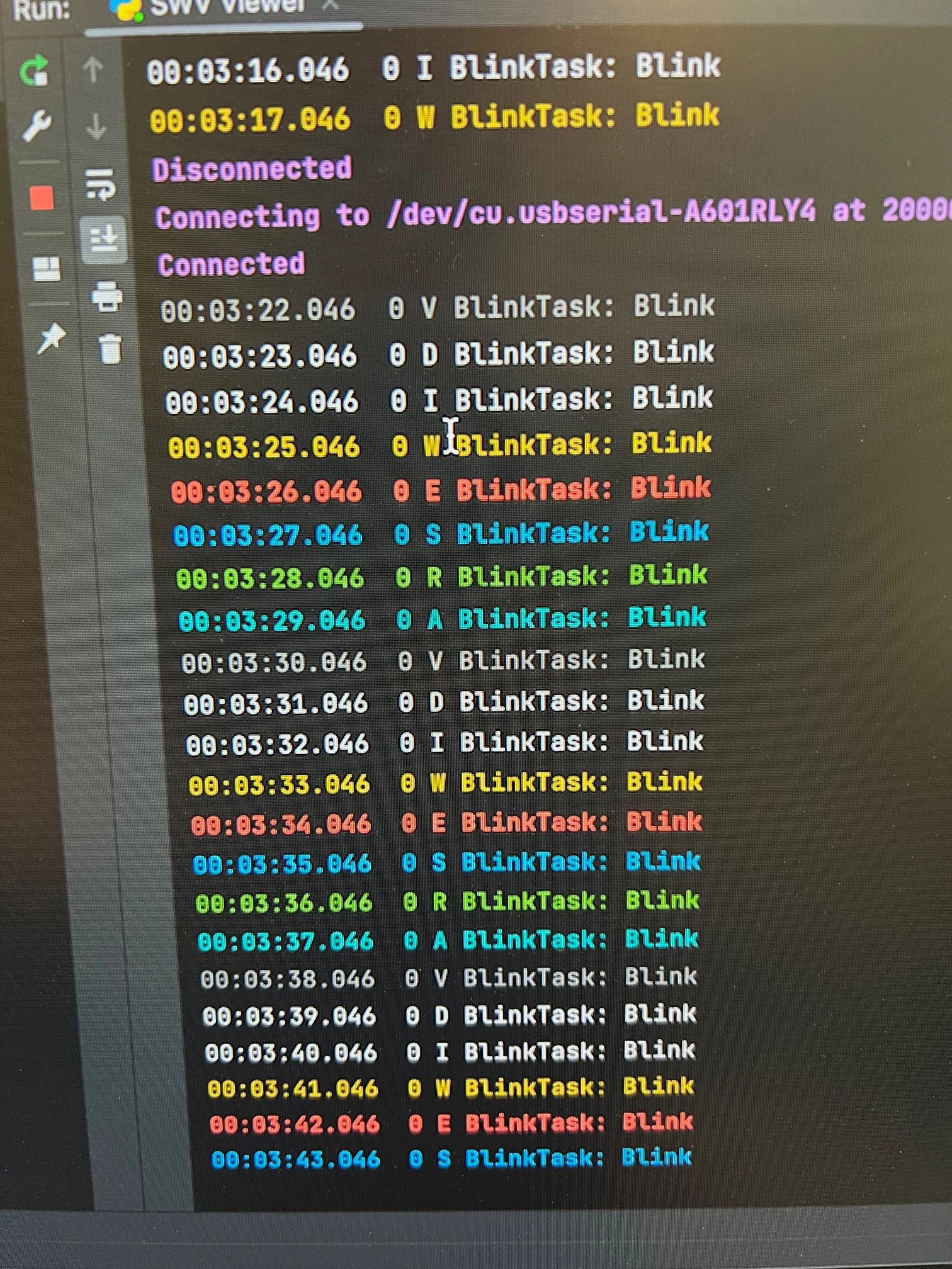

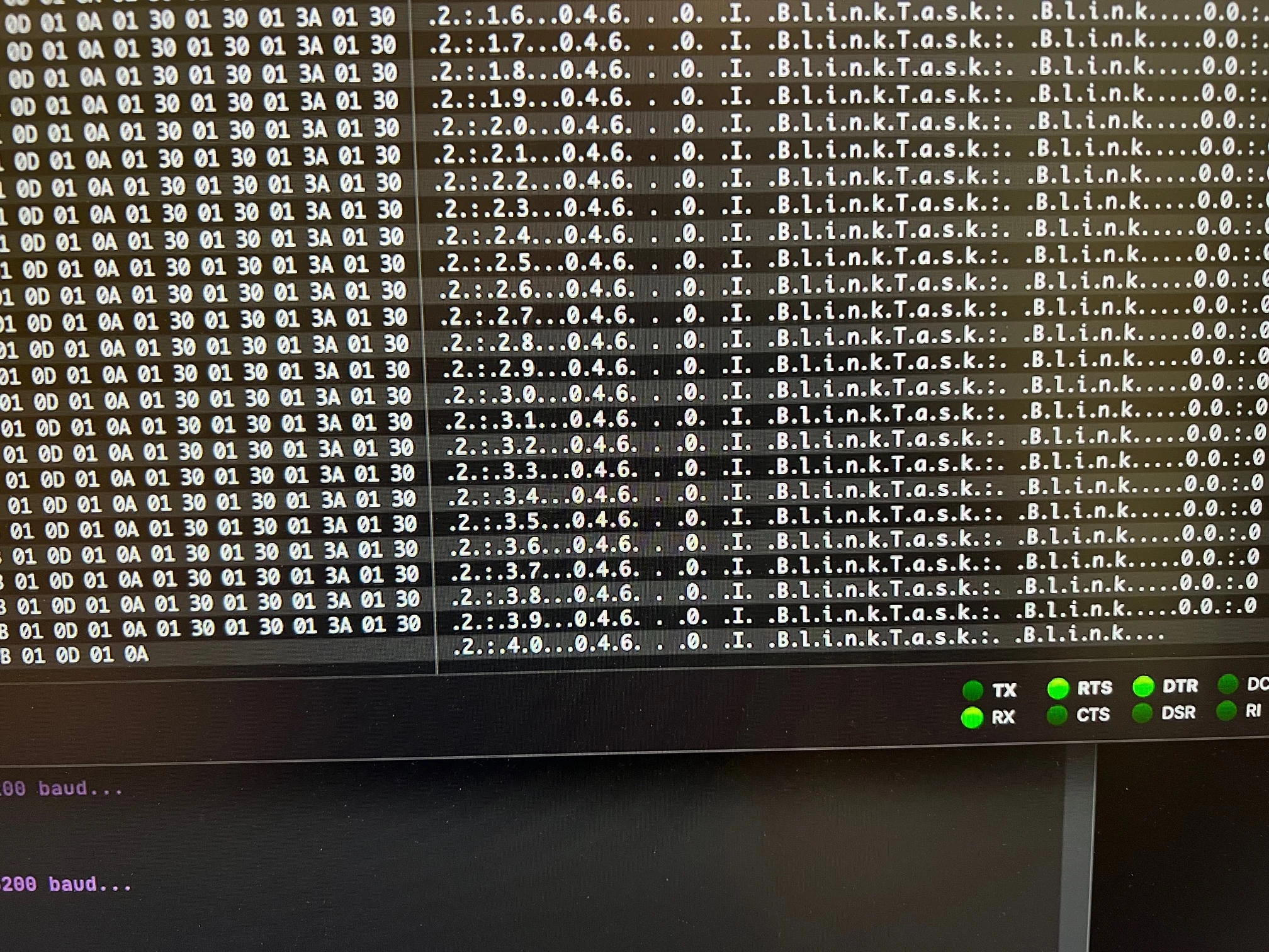

I used CoolTerm (on Mac) and connected to the USB device for the brainstem, connected and voila!:
Notice that there's an SWO control character between each log character.  I know there are some utilities out there to cope with that, but it seem simple enough just for me to modify my existing python serial view script that I use inside Clion and skip over that character.  A more robust handling can come later, but for now I'm getting this:
Here's the python script I use (note that "import serial" is for pyserial).  Note that it color codes if you format your log statements as you see in my screenshot.
