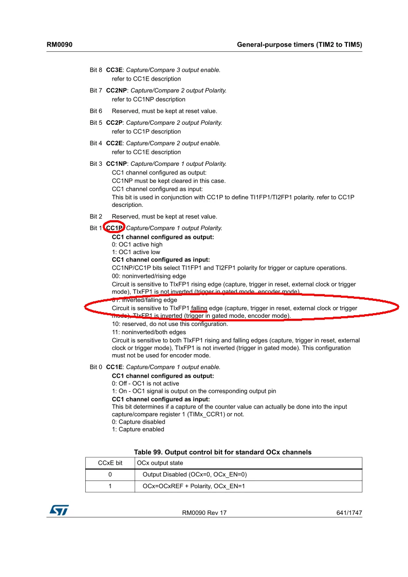

I want to  configure the DMA so that it transfers data from the GPIO lines (8 bit data lines) to the RAM buffer upon receiving a trigger signal on the timer capture input channel TIM1_CHI (PE9) . I am using stm32f446ze.We nees to acquire data register on rising edge of clock.

but we are not sure , whether the program enters the ISR on the rising edge of the external clock input.We are having this doubt because we tried toggling a pin in ISR and we found that the pin toggles on the falling edge of the Clock.
How can i verify this?Please reply asap......
Best answer by waclawek.jan
> TIM1->CCER |= TIM_CCER_CC1P | TIM_CCER_CC1E;               // rising edge
No.
No.

Thanks for your support . The program worked fine when changing the trigger edge of external clock pulse .
