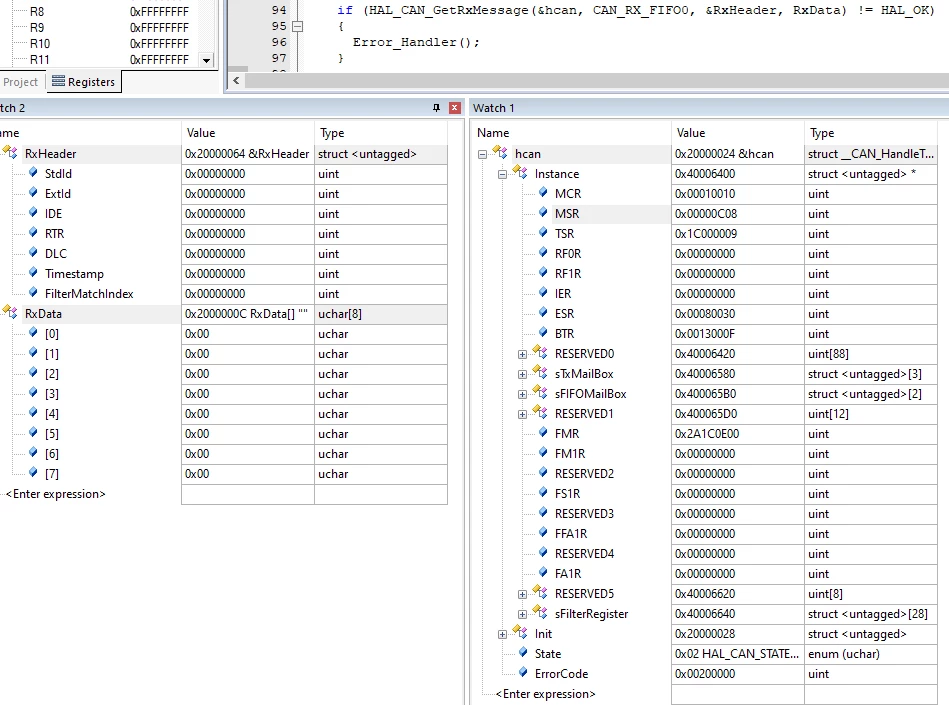

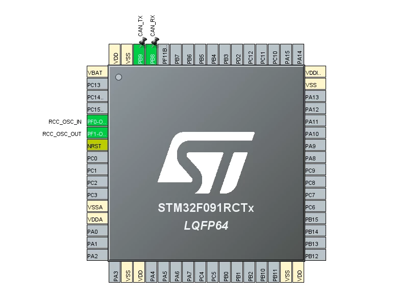

Any help? I am reading can and getting all zeros when connected to car CAN bus. Why could I get zeroes?0690X00000Buc42QAB.png
I have connected transreceviver to PB8 and PB9.

#define HAL_CAN_ERROR_PARAM          (0x00200000U) /*!< Parameter error
As I understand I am getting this error. What does this error mean and how to fix it?

>>Any help?
Unfortunately multiple degrees of separation in terms of chips, tools, and libraries.
Suspect you'll need to search/grep the library source to understand specifically what is not liked in your parameters, presumably clocks, quanta, or other combination of thing that the library determines to be internally inconsistent.

It started working!
I have calculated correct quantas by this video:
https://www.youtube.com/watch?v=rpE5UvQDcy4&list=PLERTijJOmYrApVZqiI6gtA8hr1_6QS-cs&index=14
