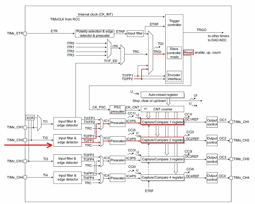

    It's probably wrong timer configuration. May be some image can help - this is one configuration fo ''PWM input capture'':
    Because you are not interesed in capturing period, you will not use Capture 2. Configure Capture 1 to catch falling edge from ''indirect'' source. Next configure TI2FP2 to detect rising edge. Set up Slave Mode Controller to reset timer. Example follows:
    icinit.TIM_Channel = TIM_Channel_2; icinit.TIM_ICFilter = 0x0;  icinit.TIM_ICPolarity = TIM_ICPolarity_Rising;  icinit.TIM_ICPrescaler = TIM_ICPSC_DIV1; icinit.TIM_ICSelection = TIM_ICSelection_DirectTI; // TI2FP2 TIM_ICInit(TIM3, &icinit);
    icinit.TIM_Channel = TIM_Channel_1; icinit.TIM_ICFilter = 0x0;  icinit.TIM_ICPolarity = TIM_ICPolarity_Falling;  icinit.TIM_ICPrescaler = TIM_ICPSC_DIV1;  icinit.TIM_ICSelection = TIM_ICSelection_IndirectTI; // signal from channel 2 (TI2FP1) TIM_ICInit(TIM3, &icinit);
    TIM_SelectInputTrigger(TIM3,TIM_TS_TI2FP2); // Event for Reset Controller from rising edge TIM_SelectSlaveMode(TIM3,TIM_SlaveMode_Reset); // Reset timer with that event
    next configure DMA to transfer data from Capture 1 register to memory (i think you want use circular mode). Enable DMA ''transfer complete'' interrupt (which will indicate that burst is over and collected data waits for you). Enable DMA request in timer (request from Capture1 event).
