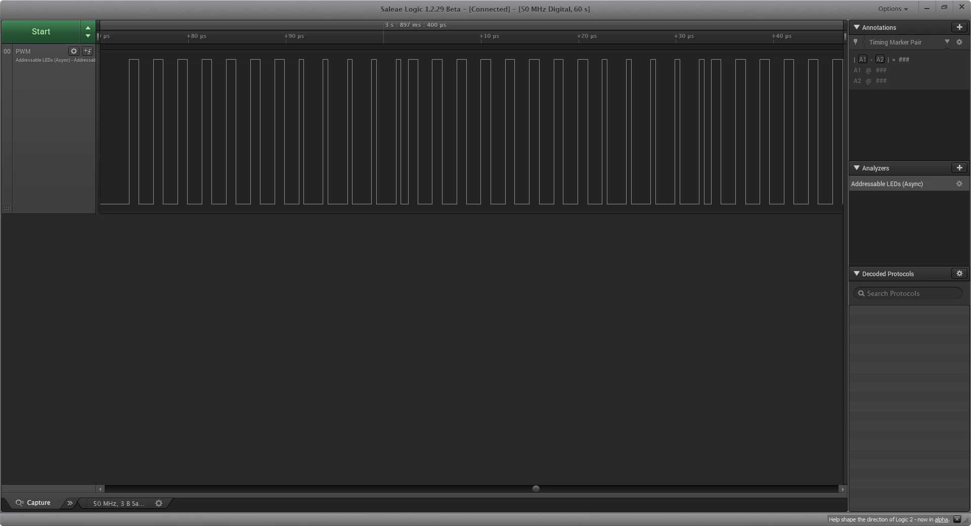

Hi guys I am using the stm32h753zi MCU and writing my own drivers to use the WS2812B led strip.
It uses a PWM to determine how much of the RGB you want.
I got the PWM part down and the OPM done, the problem is that I want to send let say a duty cycle of 80% follow by a 32% duty Cycle. I got it working for sending one burst but noted in the datasheet the OPM disables the CEN, however I can never re-enable it?
Is that how OPM works? One time and thats it?
Essentially sending a duty cycle of 80% = 1 and sending a duty cycle of 32% = 0, so thats why I want to send it in pulses in PWM form.
EDIT: 1 Using the TIM15 configured in PWM mode with DMA. The DMA will transfer from a buffer into CCR1 to alter the PW on the fly.

What I have now is
An array of pre calculated PW values for sending 1's and 0's that will transfer from the buffer into the CCR1 TIM so a Memory -> peripheral configuration. Theres no Half nor Full complete interrupt as I dont think I need to know when it finishes it. The TIM15 is configured as a PWM so when CCR1 is updated with the pre-calculated PW it should send the correct 1 and 0 pulse widths.
The problem is the DMA needs to be circular or a one shot transfer? and the PWM produced by TIM15 misses pulses and looks messed up
January 11, 2021
Good progress, keep going.
Pretty sure PFCTRL should not be set here.
It should be a one-shot transfer unless you want it to loop through the buffer again after it's done sending.
You're transferring 32-bit values while your timer is only 16-bits. I'd change the array to uint16_t values and the memory sizes to half-word. It may be transferring 0x77, then 0x00, then 0x77, then 0x00, etc, which would explain the pattern.
Not sure where you're getting DMAMUX_CxCR_DMAREQ_ID_TIM15_CH1, but it's working so it should be right. There is likely a value in the CubeH7 repo which would be more readable. Not a big deal.
I would use the update event (tim15_up_dma) which will do the transfer on update rather than the ch1 event (tim15_ch1_dma) which does the transfer on a ch1 match. For your particular values, they should behave the same, but if you want 0% or 100% duty cycle, update is going to be better.

Okay I got an update for you. Yes that 32bit, I fixed it realized CCR1 is a 16 bit register it did fixed some weird PW I was seeing on the line.
PFCTRL is not set, it puts a 0 to make it a DMA flow controller, I see why you thought that. I could remove it.
TIM15 for whatever reason has 2 DMA request TIM15_CH1_DMA, and TIM15_CH1_UP. I tried the latter but didn't work so I had to use the former.
Picture of the Updated Changes, still not perfect.
0693W000006I8ELQA0.png The array for reference:
uint16_t GREEN [25] = {0xEF, 0xEF, 0xEF, 0xEF, 0xEF, 0xEF, 0xEF, 0xEF,
		 0x77, 0x77, 0x77, 0x77, 0x77, 0x77, 0x77 ,0x77,
					 0x77, 0x77, 0x77, 0x77, 0x77, 0x77, 0x77 ,0x77, 0x00};
Like its outputting 9 0xEF? then the rest looks good, and I don't know about that last one
