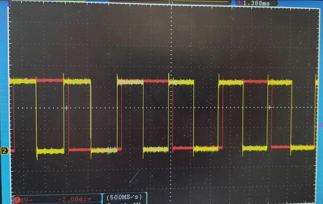

Hello everyone!
I have 2 fixed PWM of 40kHz (TIM1_CH1, TIM1_CH1N) and one modulation at 80 kHz fitted into the others, matching the steps by zero.
Instead of this, I have this signals:
There is a gap between them of 1us.
This is the timers declaration:

Any sugestion?

What do we see on that oscilloscope screenshot?
> TIM_SelectSlaveMode(TIM3, TIM_SlaveMode_Trigger);
> TIM_Cmd(TIM3, ENABLE);
No! The point of trigger slave mode is, that the master will enable the slave through the trigger, so you must not enable it manually.

Dani Prieto
May 10, 2019 6:45 AM UTC
That's it!
I have commented TIM_CMD of timer3 and it's working OK now :)
The red signal was 40KD(40kHz signal) and the yellow one was PWM of 80kHz.
Thank you for your answer!
