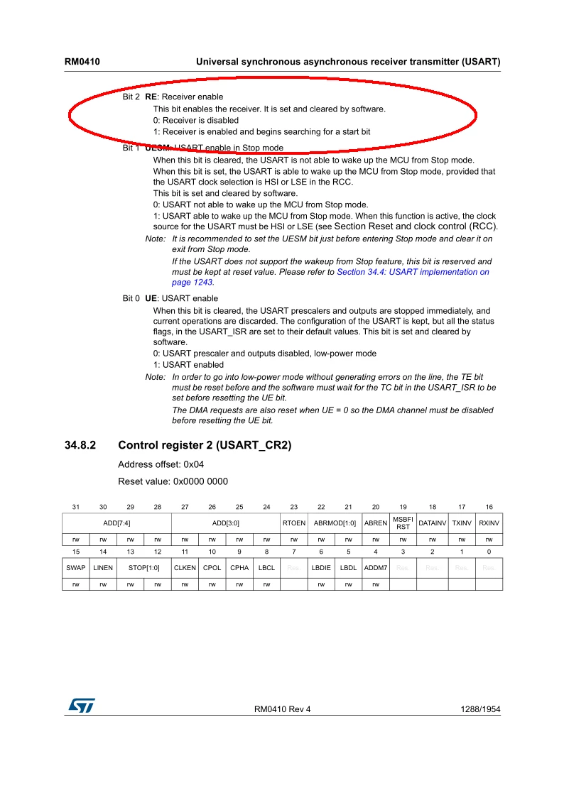

How to properly temporarily disable UART reception ?
we have UART based communication that cause crosstalk between RX and TX lines.
It can't be fixed, so I'd like to solve it in SW.
I'd like to temporarily disable/enable UART reception before/after sending on UART.
I'm already putting DMA into Pause/Resume, but I still get those crosstalk bytes (probably UART is still receiving into own buffer).
How to properly disable UART reception for some short time ?
I could do deinit_/init procedure, but maybe there is a shorter way...
thanks in advance.

waclawek.jan
July 22, 2021
0693W00000D0KcCQAV.pngJW
bully
bullyAuthor
Senior
July 22, 2021
thanks for the tip. I'll check and implement it...
Regards.

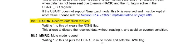

Guenael Cadier
August 2, 2021
0693W00000D1HJ9QAN.jpgIn case you want to restart reception with a clean (empty) Rx content (and discard a data that might have been received prior you disable/enable RE), you could also flush the RX path by writing 1 in RXFRQ bit in USART_RQR register.
Regards
