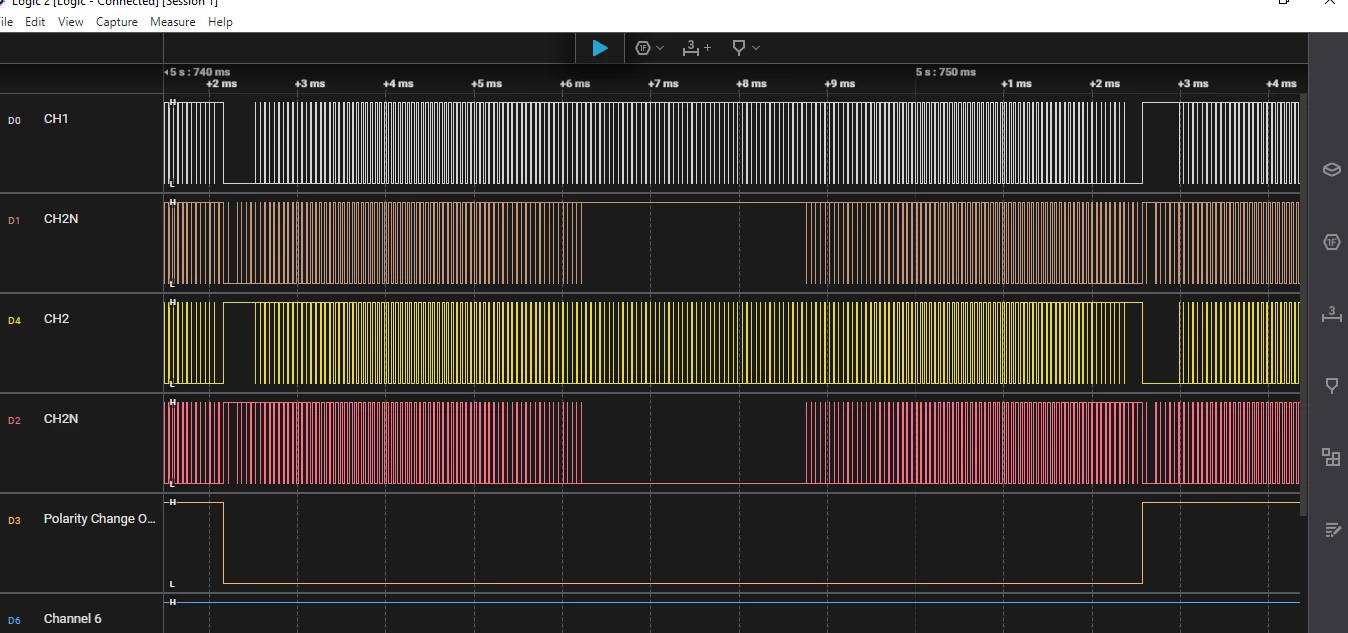

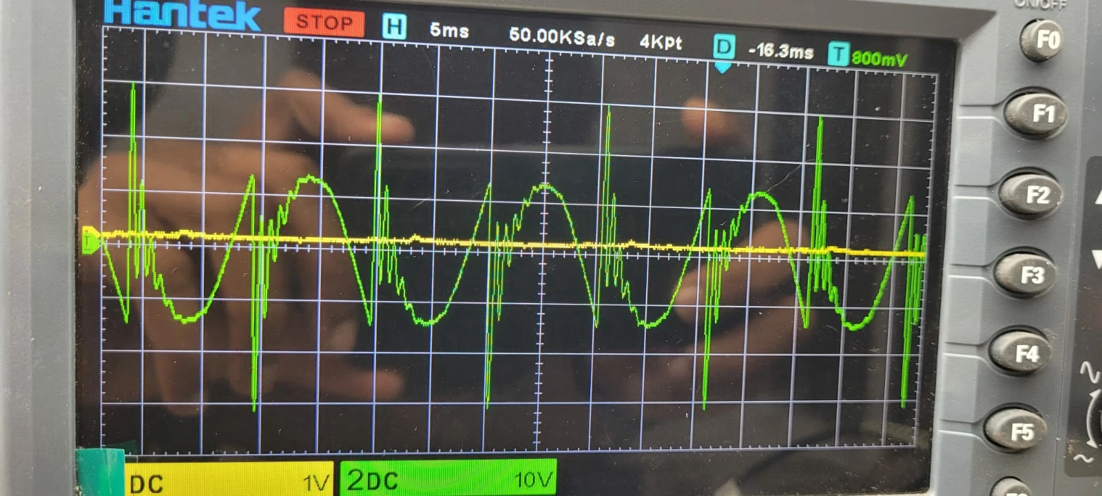

But I tried Likewise , but whenever the polarity changes its makes high spikes plese look the image
As am a beginer am dont know the exact problem
I used one Half cycle , CH1 output polarity is normal , and CH2 's polarty is inverted , whenever thehalf array value is transfered by the DMA the PWM_PulseFinishedCallback funtion trigger aand it inverter  the polarty of the channels . aand working as expected see the above logic signals .

this is the main function call
How do i get a smooth sinewave ??

Your trouble is based on schematics and MCU PWM cant create negative signal on simply invert ...
NORMAL one sine require shifted DC data... complementary based on schematics...
