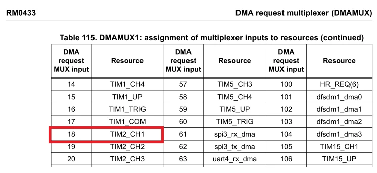

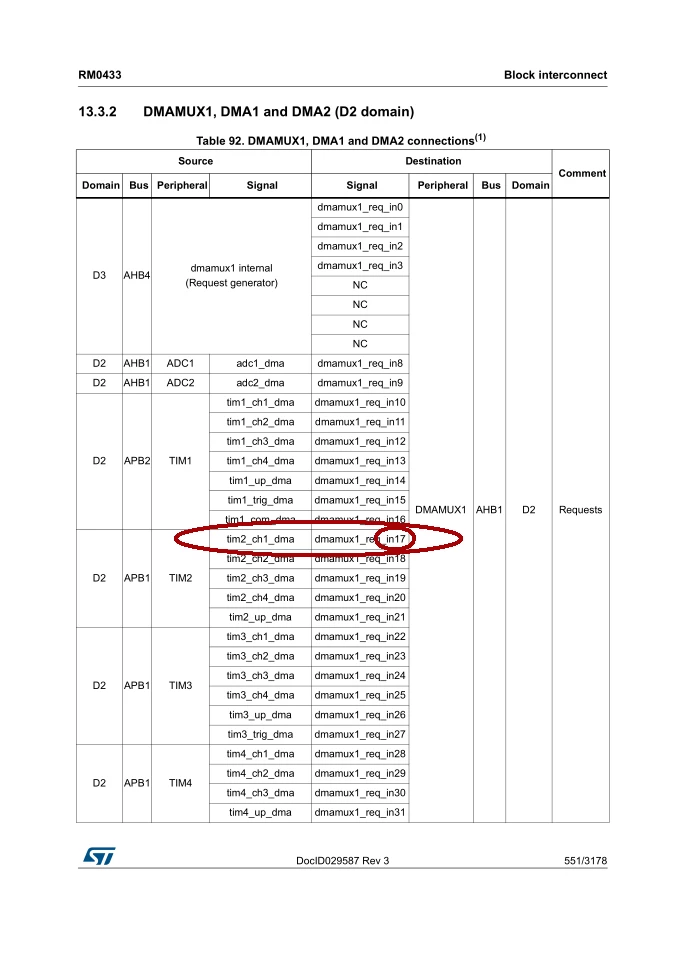

waclawek.jan
August 6, 2018
I don't 'H7, but can't this be the problem?
// NOTE: configurate TIM2_CH1 interrupt route
// set DMAMUX to route request (TIM2_CH1)
DMAMUX1_Channel0->CCR |= 18U;
I also am not fan of using magic values; instead, I recommend using the symbols from the CMSIS-mandated device header.

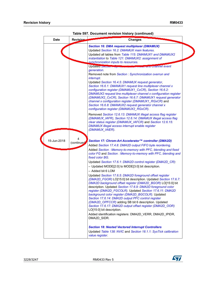

(RM0433 Reference manual STM32H743/753 advanced ARM ® -based 32-bit MCUs) 4th Revision (but it's looks like your document is different from mine, i should look into it too)

waclawek.jan
August 7, 2018
Indeed. I have an old copy of the RM.
I don't know then.
