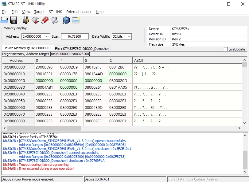

I have problem with download hex file to memory.
My project uses STM32F769 and QSPI (MX25L51245G).
Here is pin map of QSPI:
QSPI_NCS <-----------------> PB6
QSPI_CLK <-----------------> PB2
QSPI_D0 <-----------------> PD11
QSPI_D1 <-----------------> PC10
QSPI_D2 <-----------------> PE2
QSPI_D2 <-----------------> PD13
This pin map of QSPI is different with pin map of QSPI on STM32F769 Discovery board.
When I use the ST Demo hex file to program to my custom board by ST link Utility, it shows message: ''time out during flash program''.
Here is image:
Could you please help me to solve this ?

It looks like no way to change ST-LINK pin configuration to QSPI Flash.
I suggest use external programmer to program your code.

You would need to craft a custom external loader to address the specifics of your board and part choices.
