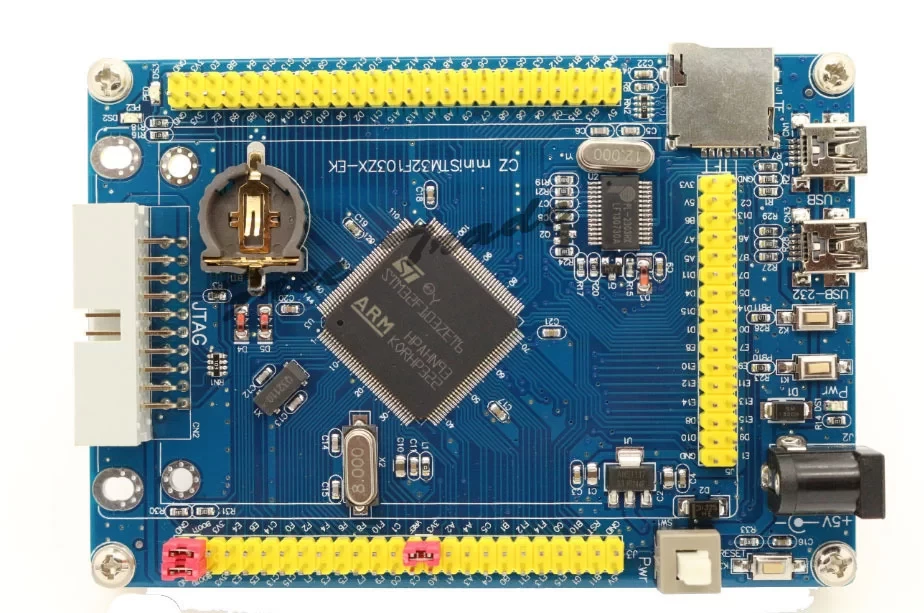

How to program the cz ministm32F103ZET6 ?
This is the board picture:
I bought it from Aliexpress, I tried to connect it to Arduino IDE but didn't connect.
There are two boot pins, how to use them ? What should I do exactly ?

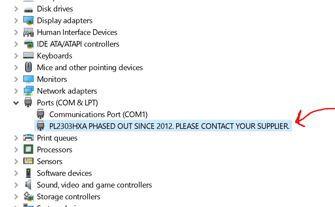

On the device manager, it displays this message:

On the F1 with BOOT0=1, BOOT1=0 you should be able to get a USB device on the primary USB connection. For there USB/DFU mode on STM32 Cube Programmer

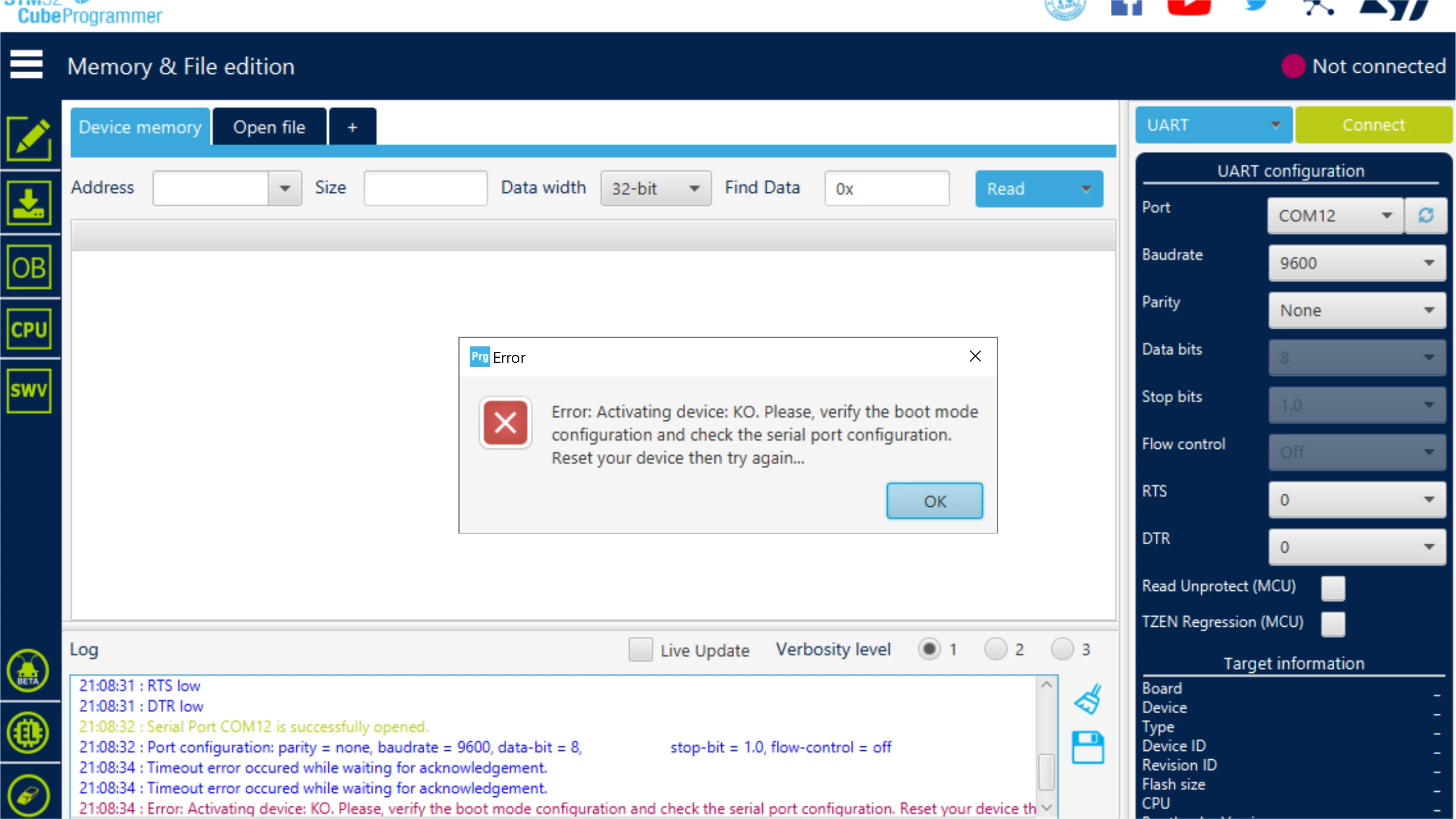

I tried but I couldn't, I pulled boot0 to GND.
I get this message:

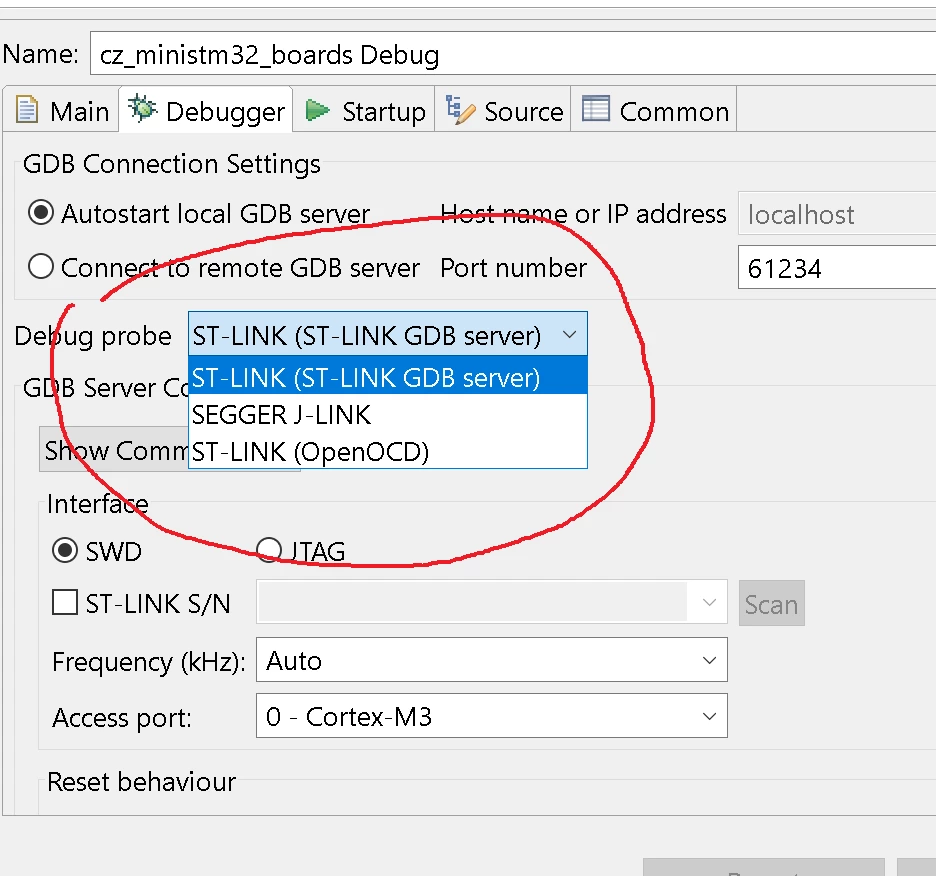

I don't have ST-LINK. I really would like to use it normally with the USB cable.

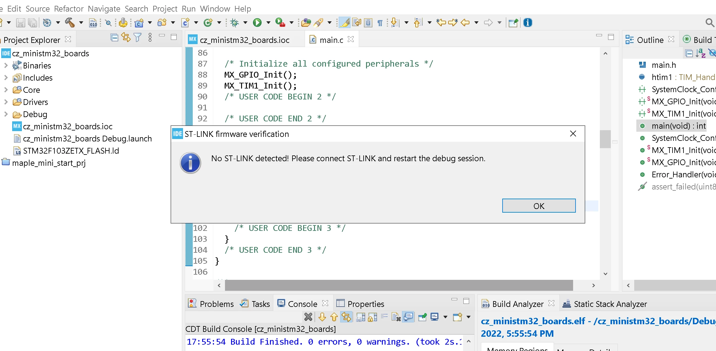

Right you DON'T have an ST-LINK, you're not going to be able to interactively do debugging and downloading from the IDE without one, or another JTAG/SWD pod
You'd need to use STM32 Cube Programmer in UART/COM Mode with the serial connection, if your other USB connector (the one not connected to the Prolific chip) connects directly to the STM32, it might come up in the system loader and report as a "STM32 BOOT LOADER" type USB device, which you can then connect in STM32 Cube Programming in USB/DFU mode.
If you want boards with built-in ST-LINK you'd need to be buying DISCO or NUCLEO boards.

Update:
I found this video which solved the driver issue.
Now the board is displayed correctly in the device manager.

Also in regard to the Cube IDE, I can't use the serial connection as the methods requires external programmers.
AAlzh.1
AAlzh.1Author
January 19, 2022
I installed the software, but I got this error, with setting boot0 to GND.

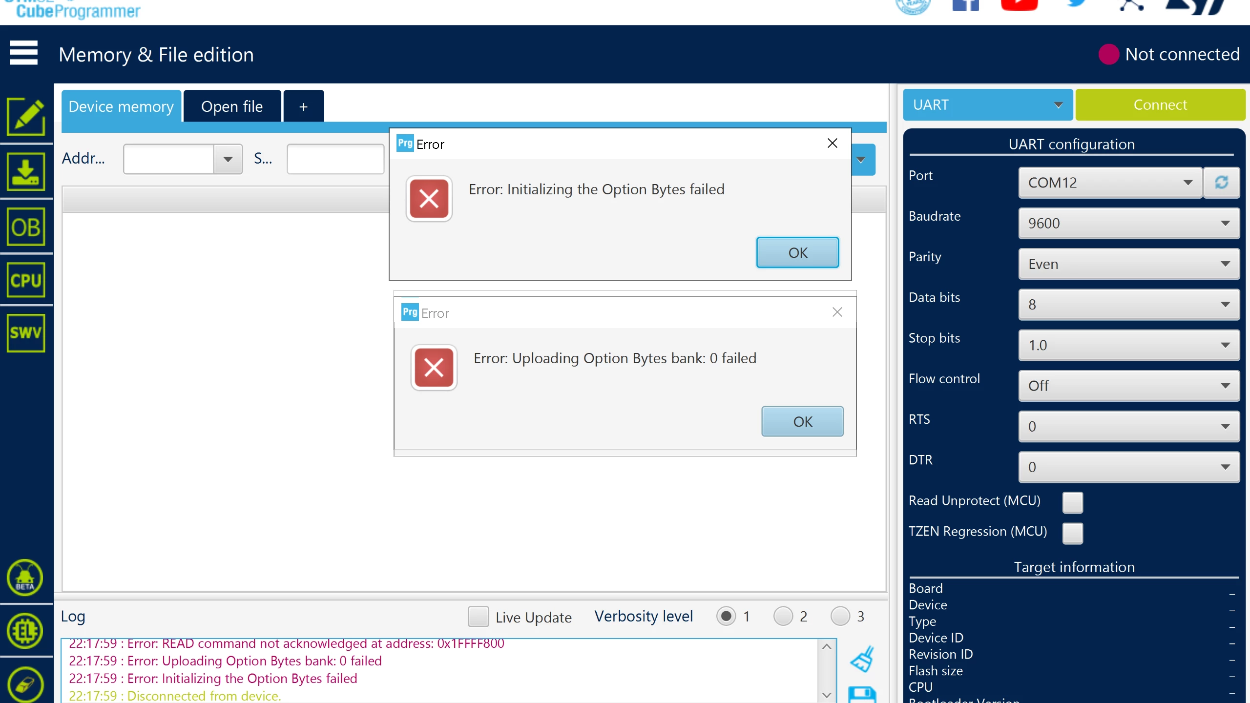

AAlzh.1Author
January 19, 2022
Setting boot1 to GND I got this:

But what if I want to program it with Cube IDE, is that possible now ? I think I have to change the bootloader, am I right ?
