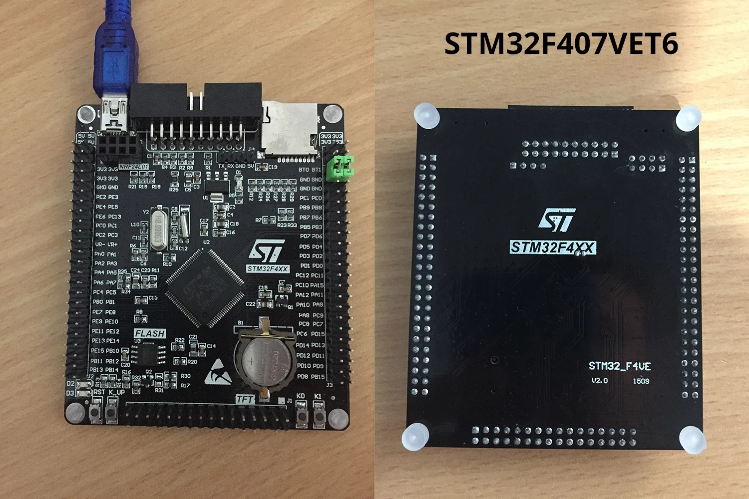

Hey everyone, I am new to STM hardware and software... Recently got a development board from a third party that's based around the aforementioned microcontroller. From what I gather you can start building on STM projects from STM32CubeMX, however I could not find the board in their board selector (as it is a third party) and im unsure how programming the board would differ from programming the bare MCU if I would simply select to use the MCU itself.
Can I proceed to program the board just by telling the software the model of the MCU, or is there a way to install an additional software package that has the board information (and is this available)? Thanks!

You could inquire if you random board vendor has template or project file.
Otherwise pick the chip, and start inputting the pins you plan to use by referring to the schematic for the board.
You don't even need to use CubeMX, there are HAL example applications under the repository trees, which you could port to your board. Perhaps start with something simple that toggles a GPIO

Ah, thank you! If the template/project file isn't otherwise available I can go that route​ and program it myself, however I bought it too long ago to contact the supplier and these boards seem fairly common, would hate to go through all the work if it were out there elsewhere in an easier format. Sorry, should have specified what board I was using as well, but here is an attached image if anyone knows.

Visually the 2x10 pin connector on the top right of the picture is a debug port compatible with ST LINK v2 debugger box. The debugger hw seems not provided.
Piranha
Principal III
April 4, 2019
So, one can get this board without a debugger for a 10 USD or get a NUCLEO-F446RE with on-board ST-LINK for a 15 USD. I don't understand why people do this to themselves...

Ah, thank you all so much! And unfortunately I only did that to myself due to ignorance about STM32s (coming from an Arduino world and still fairly green at that), didn't occur to me that there might be more to programming it than what was already on the board​.
I also found a resource elsewhere online that detailed how to program these boards using the debug port and another peripheral attachment (either an ST link or another nucleo model, can't remember for sure), it just didn't use the STM32CubeMX software so I wasn't sure if the peripheral was due to their methods or if it was necessary in general, but good to know it's just par for the course :p will definitely look more into that.
