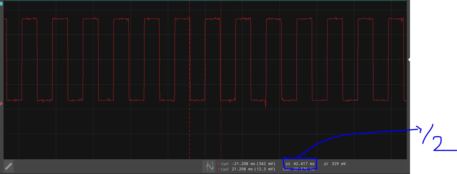

ConfusedContrarian
March 27, 2019
Thanks for the reply, I've stripped down to basics to confirm my timer works. I'm using ADC_ConvtCallback to toggle a GPIO pin. and as you can see it roughly takes 20ms.0690X00000895hUQAQ.png One thing I do notice is, the buffer is filled when using DC values (connected a DC power supply) but when I connect a signal through a frequncy generator this isn't the case
S.Ma
Principal
March 22, 2019
make the timer trigger an output channel gpio, then wire it to the ADC trigger input which will give you a signal to monitor or trigger for the oscilloscope. Make sure the trigger period is longer than the ADC conversion time...
Next, make the cyclical buffer bigger than what you need, more than double, so when you get the half transfer (half full) buffer, you have the time it takes to fill this half to perform the FFT before it's overwritten. toggle some GPIO to check how long the FFT takes (if doing continuously and not using a time sampling window).
ConfusedContrarian
March 28, 2019
This was actually veryu helpful and helped me figure out my ARR and PSC values were double what I needed, thanks!
