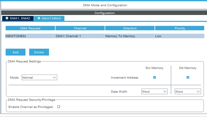

what type of DMA that you use?
Circular?
with address memory increasing?
and You had DMA Callback function too?

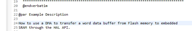

This is an example that I took from my STM32L552E-EV evaluation board. It's called DMA. No It's not circular after CubeIDE
After the readme file, it's only a transfer from Flash memory to RAM memory (after me).

Yes I the example has a DMA_callback function :
 /* Select Callbacks functions called after Transfer complete and Transfer error */
 HAL_DMA_RegisterCallback(&hdma_memtomem_dma1_channel1, HAL_DMA_XFER_CPLT_CB_ID, TransferComplete);
 HAL_DMA_RegisterCallback(&hdma_memtomem_dma1_channel1, HAL_DMA_XFER_ERROR_CB_ID, TransferError);

if it's no Circular so it's going to stop at the end of address and you have to restart it again as usual.
when you use ADC or SPI with DMA and you set memory with many byte, it's going to stop at the end of address.
you should try with circular mode.
But I'm really unsure what feature do you want. So it may useless for you.

You can either set it to circular mode so it transfers continuously, or you can restart the transfer after the transfer is complete within the TransferComplete callback.
