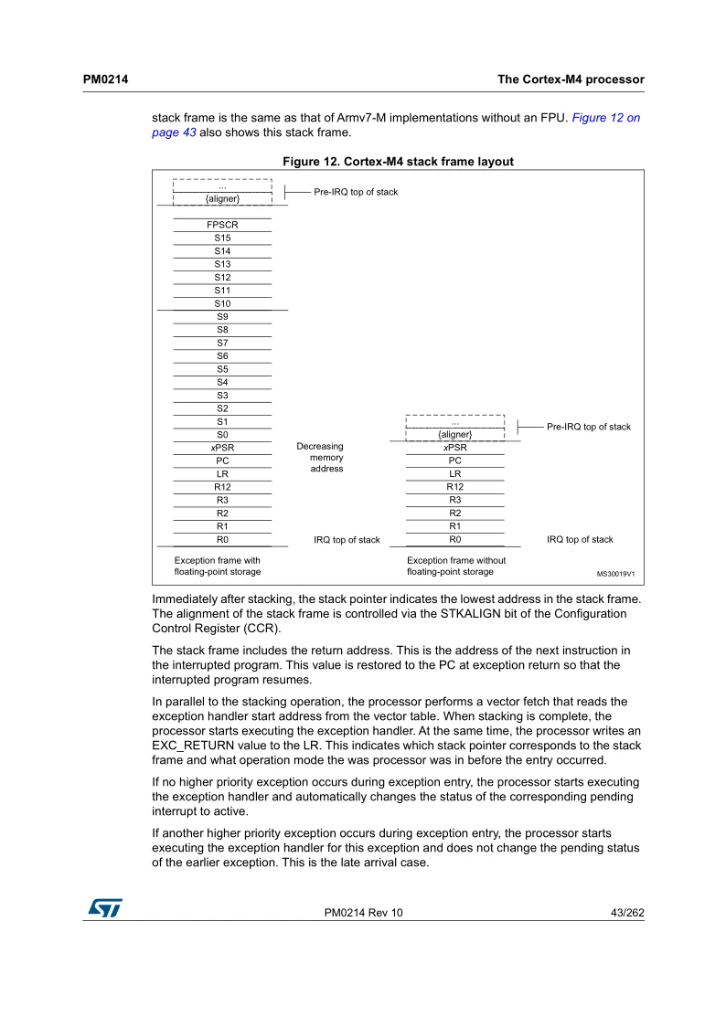

Stack is in RAM, but code (instructions) are in Flash, usually. Stack contains data like local variables, saved register values, and exception/return addresses which point to code.
Read PM0214 Programming manual cited by Jan below or a good book on that topic (Joseph Yiu). Try stepping though sample code and watch what happend and how the stack is used.

> Is there any resources about recording information on stack for STM32F4?
0693W000006F2gXQAS.png In your case, PC is 0812CA9A , i.e. the faulting instruction will be at that address or a few addresses before that address (in case of imprecise fault).
