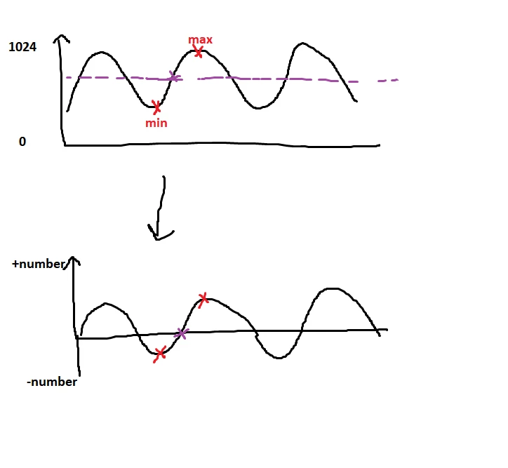

How to measure RMS voltage and Current coming from AC supply and calculate
Hi, i need to measure rms voltage and current choosing ADC channels in stm32f103.
i selected two channnels in ADC1 to read adc values . By using these channels i need to calculate rms voltage and current . But i am confused how to do it . is it necessary to do calibration also. can anyone help me how to write a code or how to start it please.

True RMS calculation:
1.Detect the 0 crossing (here is where the magic is)
2. offset your adc readings tothat 0
3. calculate the root square of every sample and average the results.
(the more samples you get the more precise your result is)0693W000007EhK5QAK.png
Cheap-fix RMS calculation:
if your signal is going to have a very stable dc component (same average all the time) you can just make a peak detector and do Vrms=(1/sqrt2)*(Vmax-Vavg)

Feb 10, 2021 11:53 AM UTC
 if(HAL _ADC _Start _DMA(&hadc1, (uint32_t*) adc Buffer, TOTAL_CHANNELS) != HAL_OK)
  return 0;
if(RMS _Sample_ Counter<RMS_TOTAL_SAMPLES) // it is given inside timer interrupt by setting 1kz
for(index1=0;index1<2;index1++)
temp_ ADC = adc Buffer[index1];
V1[index1] = V1[index1]+((float)temp _ADC*(float)temp _ADC);
V2[index1] = V2[index1]+(float)temp _ADC;
RMS _Sample _Counter++;
while(1)
 Delay_Count++;
 if(Delay_Count>=2500)
  Delay_Count = 0;
  if(RMS_Sample_Counter>=RMS_TOTAL_SAMPLES) // i have set RMS_TOTAL_Samples as 1000
  for(indx=0;indx<2;indx++)
  //RMS_value[indx] = ((sqrtf((V1[indx]/100000.0)-((V2[indx]/100000.0)*(V2[indx]/100000.0))))/15.5);
  RMS_value[indx] = ((sqrtf((V1[indx]/1000.0)-((V2[indx]/1000.0)*(V2[indx]/1000.0))))/caliberate_factor);
  if(RMS_value[indx]>1.5)
  Actual_Amps[indx] = RMS_value[indx];
  else
  Actual_Amps[indx] = 0.0;
  for(indx=0;indx<3;indx++)
  //Amps_Reading[indx] += 0.1;
  if(Amps_Reading[indx]>30)
  Amps_Reading[indx] = 0;
  Actual_Amps[indx] = Amps_Reading[indx];
  V1[indx] = 0;
  V2[indx] = 0;
  RMS_Sample_Counter = 0;
this is the code i have done to calculate rms voltage and current can anyone help me if anything i need to add or is my code correct please
