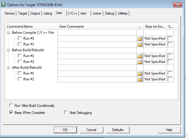

How to make the firmware as a bin file ?
Posted on November 07, 2017 at 04:50
I'd like to make and upload the firmware file into STM32F103C8 board by using UART.
Especially, STM32F103C8 board have boot mode switch and uart connect.
How to make firmware *.bin file to upload to STM32F103C8 by using MDK?

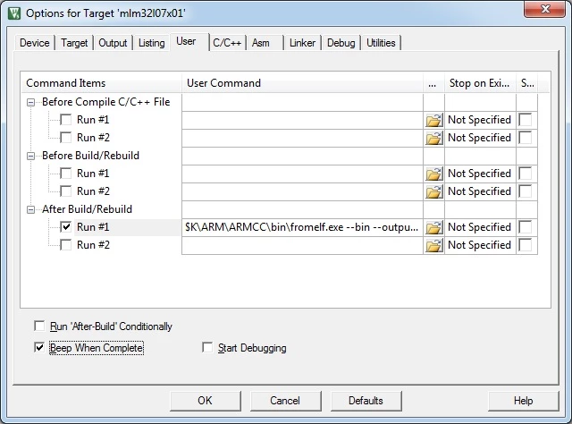

    After Build/Rebuild, Run ♯ 1
    , figure you are processing the .AXF after the linker has generated it. Pretty sure there is documentation.0690X00000604CFQAY.jpg

    Keil has a FromELF utility, you can run it from the user tab to build a .BIN file.
    $K\ARM\ARMCC\bin\fromelf.exe --bin --output=@L.bin !L
    Carter Lee
    Nov 7, 2017 5:14 AM UTC
    Posted on November 07, 2017 at 05:14
    Would you mind let me know what should I do for applying ''
    $K\ARM\ARMCC\bin\fromelf.exe --bin --output=@L.bin !L''?
