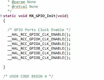

I've been trying to make LED blink. GPIO PE1. So i wrote this code:
HAL_GPIO_TogglePin(GPIOE, GPIO_PIN_1);
HAL_Delay(200);

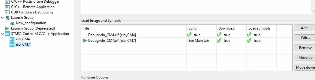

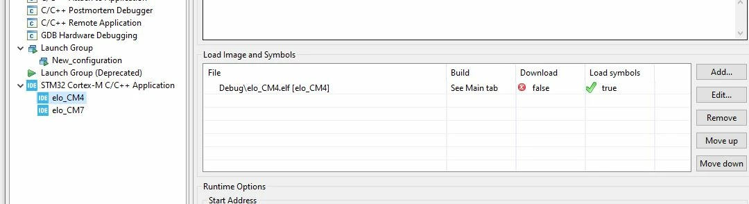

When i'm creating procject for this board it creates two procject for each core CM7 and CM4 each with it's main.c. I can debug each core but i can't figure out how to make both of them to work at the same time. CM7 seems to bo working fine when debuging but it stopping at: timeout = 0xFFFF when i hit play it runs but led is not blinking.

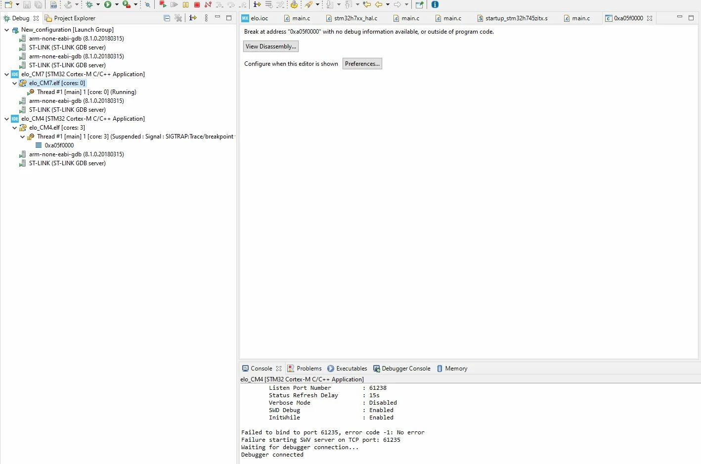

When i try to debug CM4 whitout any code exept generated one, it stops at: _HAL_RCC_HSEM_CLK_ENABLE(); when i hit play im receivng: Break at address "0xa05f0000" with no debug information available, or outside of program code.

Did you enable the GPIOE clock? I'm assuming the toggling is done within the main loop.

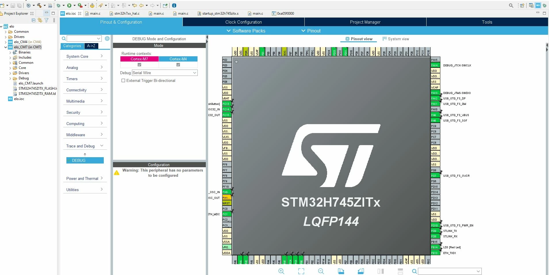

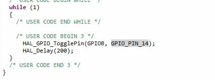

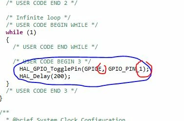

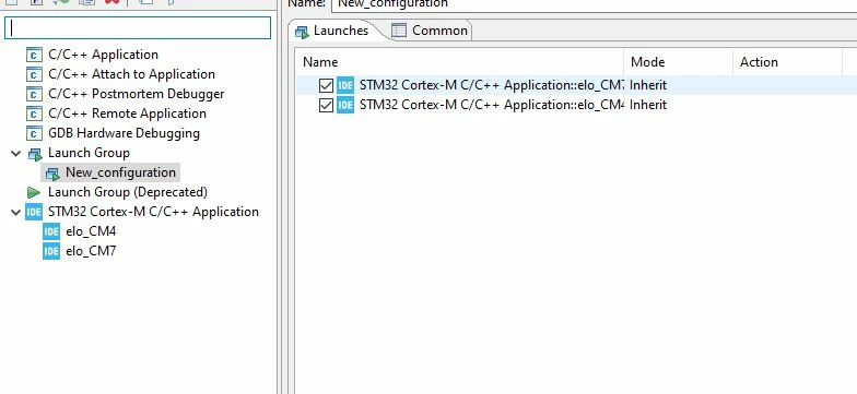

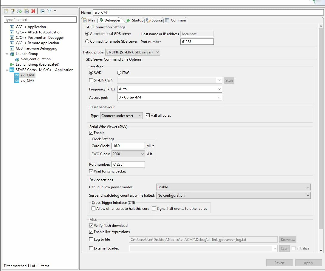

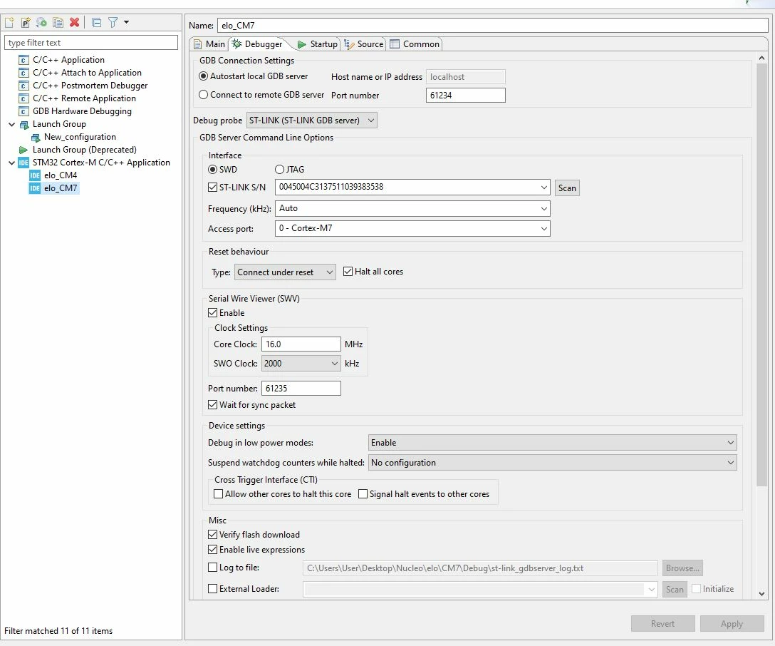

I've been trying to make it work for some time. Can you look at those screenshots from CubeIDE? Maybe you will find something out of order. Code is from CM7 main.c i didn't change anything in CM4 main.c.

It doesn't look like the GPIOE clock is enabled. There needs to be a call to __HAL_RCC_GPIOE_CLK_ENABLE() prior to using those pins. It is enabled for other ports, but not GPIOE.

But GPIOB is enabled and still its not working. maybe mcu is broken and im just connection to ST-Link thats all. Is there a way to reset this nucleo board to default? maybe i've changed something on some point.
January 6, 2021
Please read carefully: The LED is on GPIOE, not GPIOB. Which clock do you think needs enabled?
Good luck.
If you assign the pin as output and assign its context to the M7 core, it will initialize it for you during CubeMX code generation. Otherwise you need to do it yourself.
KBile.1
KBile.1Author
January 6, 2021
Yes! Finnaly i've make it work. Thank You. I didn't assign GPIOE to the M7 context in MX and that was the reason for it not beeing able to work. I still don't know why GPIOB was not working since B port Clock was enabled but maybe i need to assign it to the Core anyway.
