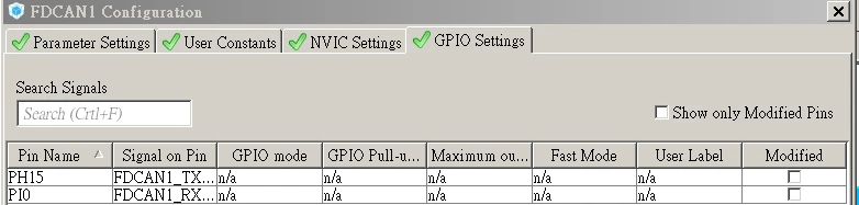

    While generating STM32H743 project by CubeMX, I noticed that FDCAN1 can be either 'master mode' or 'full-duplex mode', and they map to different pairs of signal pins ( FDCAN1_TX/RX and
FDCAN1_
TXFD/RXFD ).
    I found that
FDCAN1_
TX/RX works in both modes, but
FDCAN1_TXFD/RXFD did not work in any mode.
    The problem is that I have a need to make FDCAN1_TXFD/
FDCAN1_RXFD work, would anyone give me any advice?  Thanks in advance!

    Aaron Chang
    September 19, 2017
    Posted on September 19, 2017 at 03:30
        I was already using STM32CubeMX 4.22.1 and STM32Cube FW_H7 V1.1.0.
    The CubeMX suggested me using PH15 and PI0 but did not generate any setting for those GPIOs.
    So I added some code and set those GPIOs as ''Alternative Function 9 (FDCAN1)'', but they did not work.
    Besides, I was wandering why those settings are ''n/a'', does that means the hardware is not ready for using yet?
