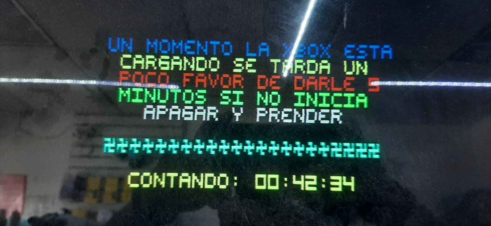

EDIT: I added a pic, to show, that my code works, but my objetive, is to pulish the code, =)
