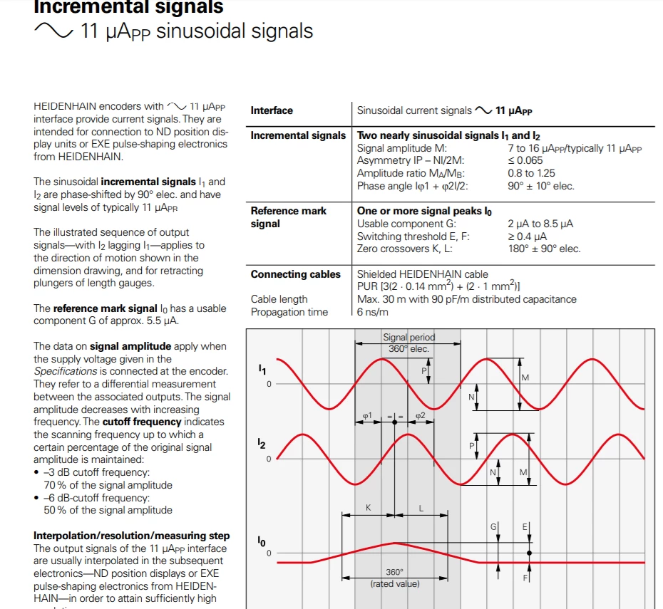

Hi everyone,
With my STM32F103C8T6 I would like to receive the 2 signals I1 and I2 from the picture below in order to convert to
https://community.st.com/tags#/?tags=square%20signal
.All the square part is already coded and working great.
Now I would like to learn how to use this
https://community.st.com/tags#/?tags=sine%20waveform
and#
signal and interpolate them such as the file attached in order to have a decent precision. For example, in my case the step of the wave is 20 microns so I would like to interpolate it by 20 in order to have 20 pulses of 1 micron.This is an optical ruler on a milling machine so the ruler can travel in both ways with numerous direction changes
I'm a hobbyist so any bite of code is very welcomed
Right now, I only use Std periph lib, not HAL libraries.
Thank you for your help
