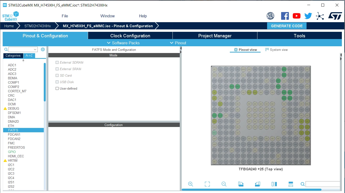

Hi all,
This is my first project trying to configure an EMMC memory with my stm32H743XIH MCU, and unfortunatly i didnt find any exemples of projects so i can understand how this works !

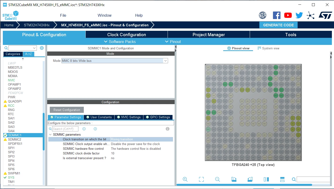

I'm facing two problems on my first try project :
1) Create project on cubeMX
  • SDMMC ==> MMC 8bits Wide Bus
  • FatFS ==> Couldn't select it on cubeMX (i think only available with SD Cards)
2) I found no exemple of code to read/write from an emmc memory, all projects i found are with SD Cards.
I will appreciate any help from you guys :)
Thank you.

STM32Cube_FW_H7_V1.8.0\Projects\STM32H745I-DISCO\Applications\FatFs\FatFs_Shared_Device\Common\Src\mmc_diskio.c

Sorry not using the Cube stuff here, but there should be example code for the H745I-DISCO that will port.

Not sure I understand the question, the HAL contains support for MMC, the FatFs middleware is usable everywhere, just need to tailor the DISKIO layer to the medium/driver. ST's made most of the interfaces in an orthogonal way, so most times you can do a search/replace for most of the API, and then do a bit of cleanup.
Materially very similar to the SD Card implementations. Depend how confortable you are with porting existing things as templates, or merging in the individual components.
