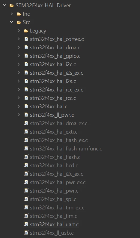

Thanks for getting back so quick. I've done what you recommended and am close but am running into another road block. Now whenever I build the function HAL_UART_Init() is being flagged as undefined. I realized that for some reason the file "stm32f4xx_hal_uart.c" was not properly being included. Looking in the driver folder the file is present, but greyed out. I placed "#define HAL_UART_MODULE_ENABLED" in the 'stm32f4xx_hal_conf.h' file in the Inc folder. This should include the UART .h file, and in turn, the .c file but it doesn't appear to. Additionally if I attempt to simply place #include "stm32f4xx_hal_uart.c" at the top of main the build claims so such file exists. Any idea why this might be?
I've attached an image of how the HAL driver folder appears in my project manager.
 #include "../Src/stm32f4xx_hal_uart.c" at the *bottom* of main.c  ))

Huge help that worked! But now the stm32f4xx_hal_uart.c file has an error where it says the ATOMIC_CLEAR_BIT and ATMOIC_SET_BIT functions are undefined. Sorry this is a confusing one for me!

ATOMIC_SET_BIT, ATOMIC_CLEAR_BIT are defined in Drivers/CMSIS/Include/stm32f4xx.h
If this is undefined, you may be using outdated version of CubeF4 package or weird mix of versions => not going to work. Please check that you have at least a certain consistent version of the F4 HAL & CMSIS library.
