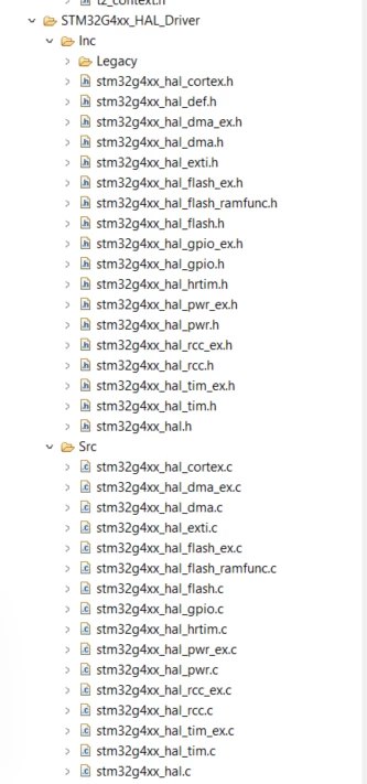

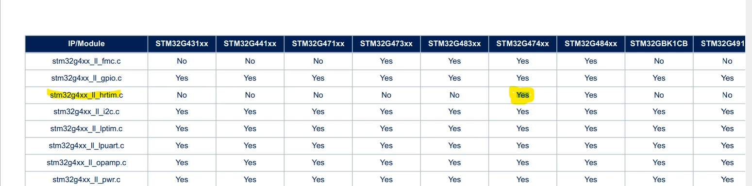

Hi there, I have been using STM32G474, but if I look into the HAL driver folder structure I cannot find the files for LL-Drivers. I want to use LL functions in my code.
Looking forward to your quick suggestions.

In the internal structure of your project you cannot find the LL libraries because you have generated the project with CubeMX by setting to use the HAL libraries.
You have to manually include the LL libraries which you can find in the STM32Cube repository on your computer.

@Andrea Canepa​  Thanks for the suggestion. Based on it, actually, I downloaded the official repository of STM from GitHub, and in that, I found the libraries for LL. The only issue which I have been facing is that when I add these files to my project's folder named "Driver". The moment I build my project after implementing changes in my code, all the added files vanish and I only see the standard HAL files which were already there from the beginning. What would you suggest?
https://github.com/STMicroelectronics/STM32CubeG4/blob/master/Drivers/STM32G4xx_HAL_Driver/Inc/stm32g4xx_ll_hrtim.h

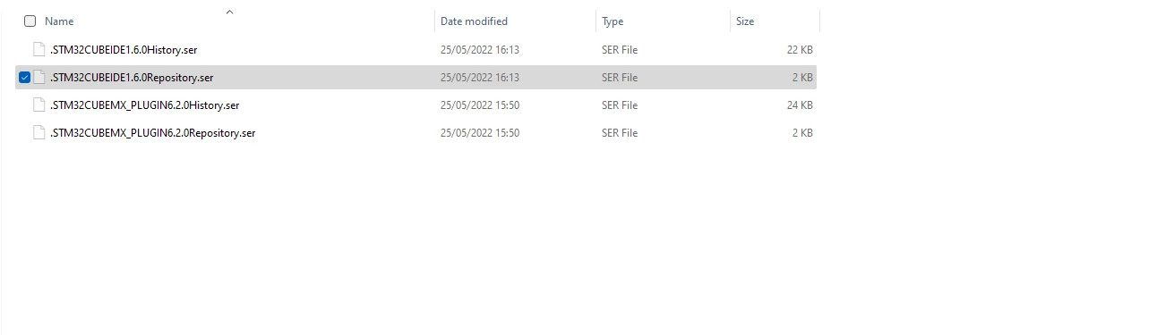

@Andrea Canepa​ I tried to follow your path but the thing is inside of "stmcube" folder, I could only see these files with the strange extensions

I don't know why you don't have the libraries in the standard location, but you can use the files you downloaded from GitHub. You just have to place them in a different folder to prevent them from being deleted during the code generation by CubeMX.
